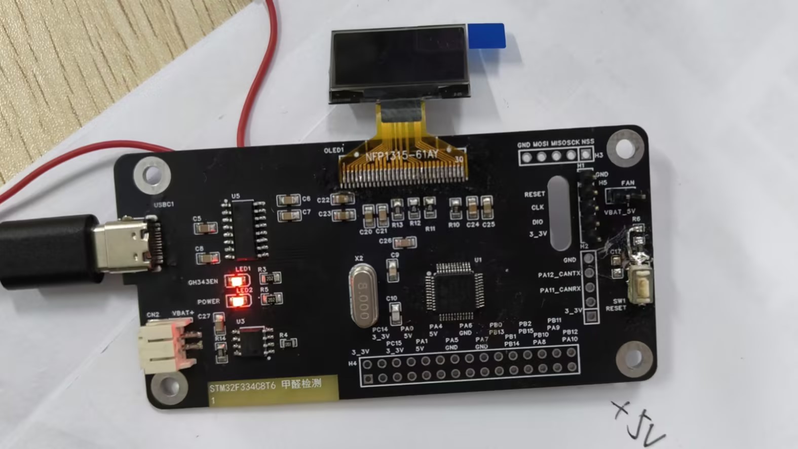

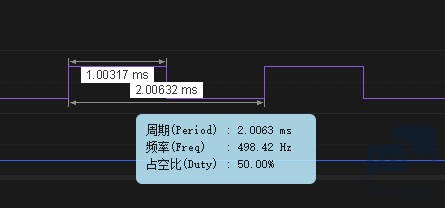

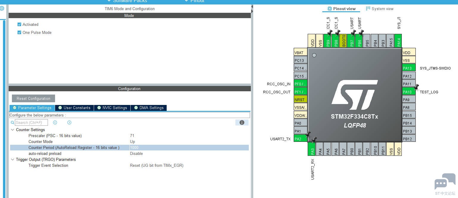

实验
实现一个定时器,1S 反转 IO 电平
配置
软件
    __HAL_TIM_ENABLE(&htim6);
    while(!__HAL_TIM_GET_FLAG(&htim6, TIM_FLAG_UPDATE))
      // Wait for the timer to finish
    __HAL_TIM_CLEAR_FLAG(&htim6, TIM_FLAG_UPDATE);
    HAL_GPIO_TogglePin(TEST_LOG_GPIO_Port, TEST_LOG_Pin);
结果
