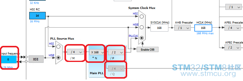

借助STM32CubeMX,可以方便地配置系统时钟:& r2 u; ^& v" n/ C6 u# \; a
* H9 K- G3 H( ^- S# ~" k3 N0 e/ u) ^+ P% C: V3 W3 A" p  I
根据上图配置系统时钟所需正确参数:/ u/ g- a; T: m8 {! a" _9 I
M=4     ( PLL_M)
3 {' {! e0 n2 y2 T- R0 vN=168  (PLL_N)( k3 w3 O3 V& E0 e) j! c. A. X
P=2      (PLL_P)# w+ P6 m1 A" }7 P
Q=4      (PLL_Q)
