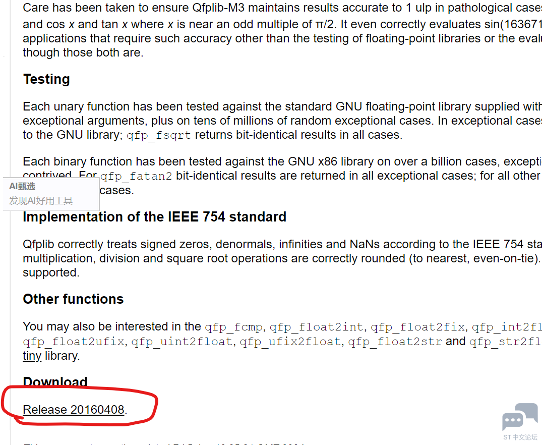

1。首先下载qfplib
https://www.quinapalus.com/qfplib.html
我们点击M3
进行下载

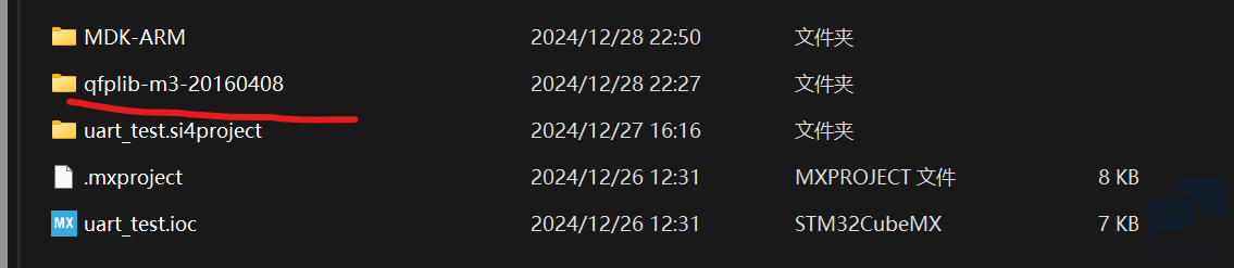

复制到工程文件夹

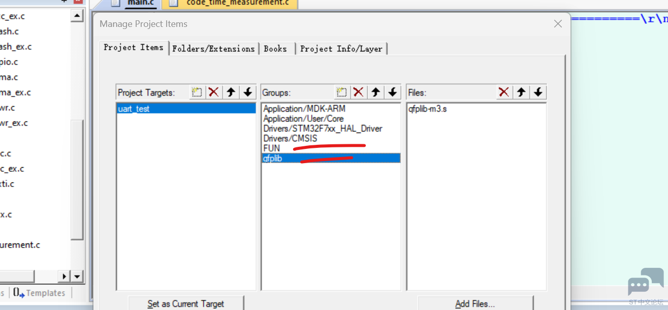

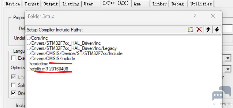

2。打开我们之前建立好的串口工程,串口打印这里不在赘述。

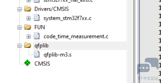

添加这两个,上面是用来测量算法时间,下面是qfplib
同时添加文件

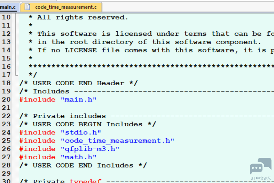

3。main文件中进行修改
添加头文件
include "main.h"
/ Private includes ----------------------------------------------------------/ / USER CODE BEGIN Includes /
include "stdio.h"
include "code_time_measurement.h"
include "qfplib-m3.h"
include "math.h"

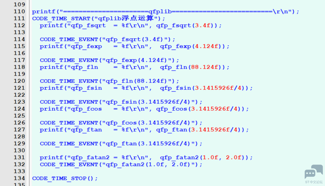

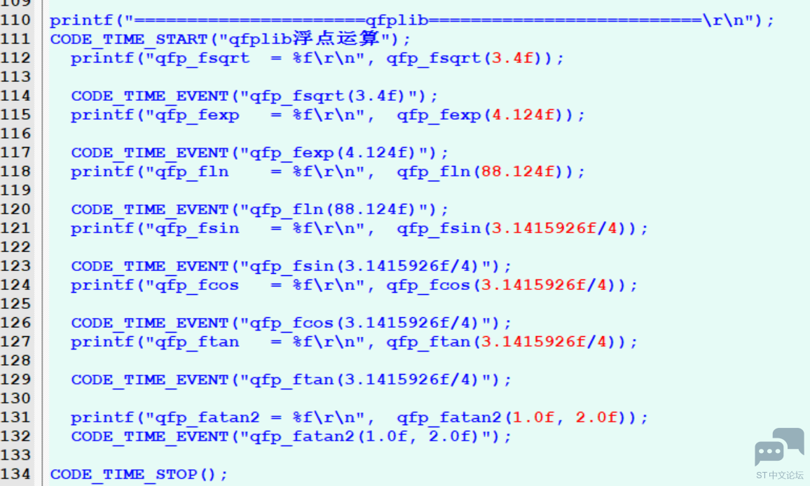

4。先进性qfplib浮点库性能测试,修改代码如下
printf("======================qfplib==========================\r\n"); CODE_TIME_START("qfplib浮点运算"); printf("qfp_fsqrt = %f\r\n", qfp_fsqrt(3.4f));
CODE_TIME_EVENT("qfp_fsqrt(3.4f)"); printf("qfp_fexp = %f\r\n", qfp_fexp(4.124f));
CODE_TIME_EVENT("qfp_fexp(4.124f)"); printf("qfp_fln = %f\r\n", qfp_fln(88.124f));
CODE_TIME_EVENT("qfp_fln(88.124f)"); printf("qfp_fsin = %f\r\n", qfp_fsin(3.1415926f/4));
CODE_TIME_EVENT("qfp_fsin(3.1415926f/4)"); printf("qfp_fcos = %f\r\n", qfp_fcos(3.1415926f/4));
CODE_TIME_EVENT("qfp_fcos(3.1415926f/4)"); printf("qfp_ftan = %f\r\n", qfp_ftan(3.1415926f/4)); CODE_TIME_EVENT("qfp_ftan(3.1415926f/4)");
printf("qfp_fatan2 = %f\r\n", qfp_fatan2(1.0f, 2.0f)); CODE_TIME_EVENT("qfp_fatan2(1.0f, 2.0f)");
CODE_TIME_STOP();

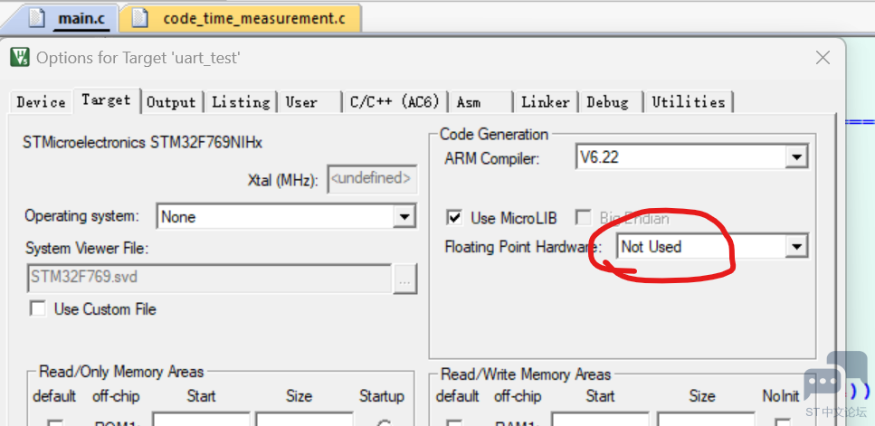

一定要关闭硬件浮点运算,操作如上图

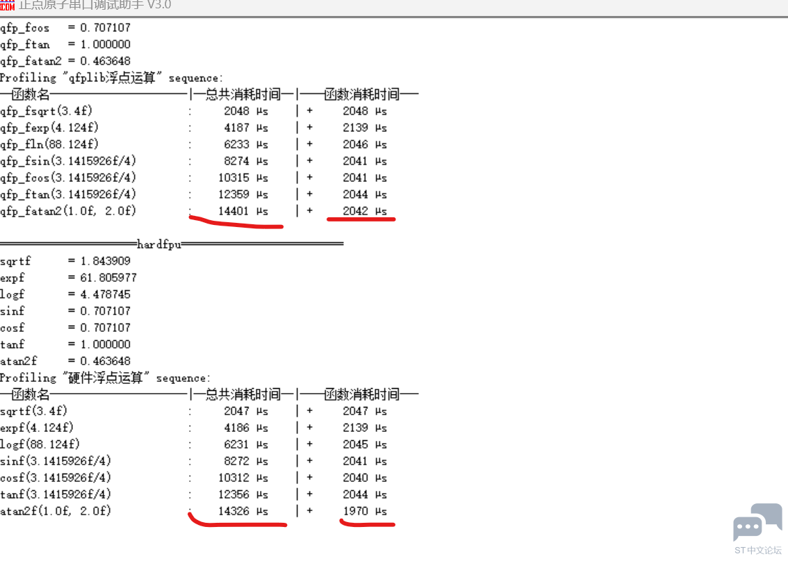

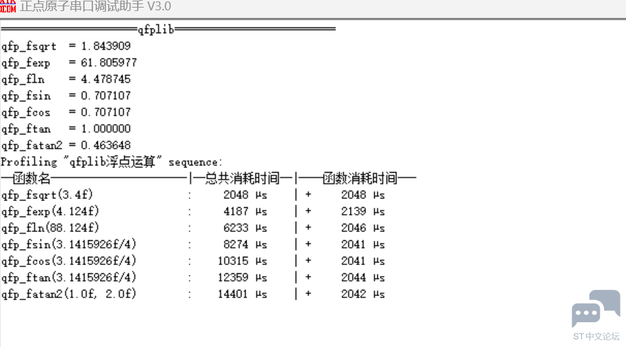

串口打印如下图

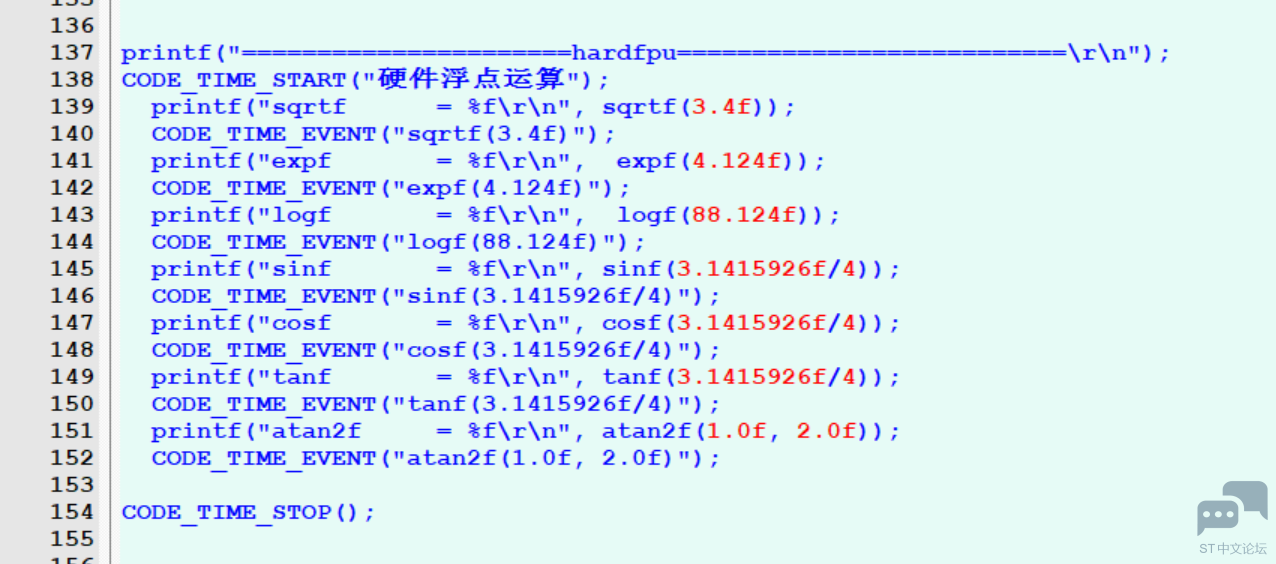

5。进行硬件浮点运算,修改代码如下
printf("======================hardfpu==========================\r\n"); CODE_TIME_START("硬件浮点运算"); printf("sqrtf = %f\r\n", sqrtf(3.4f)); CODE_TIME_EVENT("sqrtf(3.4f)"); printf("expf = %f\r\n", expf(4.124f)); CODE_TIME_EVENT("expf(4.124f)"); printf("logf = %f\r\n", logf(88.124f)); CODE_TIME_EVENT("logf(88.124f)"); printf("sinf = %f\r\n", sinf(3.1415926f/4)); CODE_TIME_EVENT("sinf(3.1415926f/4)"); printf("cosf = %f\r\n", cosf(3.1415926f/4)); CODE_TIME_EVENT("cosf(3.1415926f/4)"); printf("tanf = %f\r\n", tanf(3.1415926f/4)); CODE_TIME_EVENT("tanf(3.1415926f/4)"); printf("atan2f = %f\r\n", atan2f(1.0f, 2.0f)); CODE_TIME_EVENT("atan2f(1.0f, 2.0f)");
CODE_TIME_STOP();

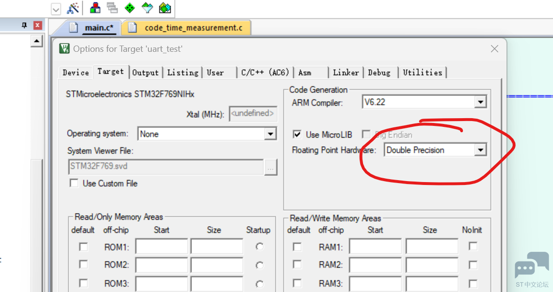

同时使能硬件浮点运算

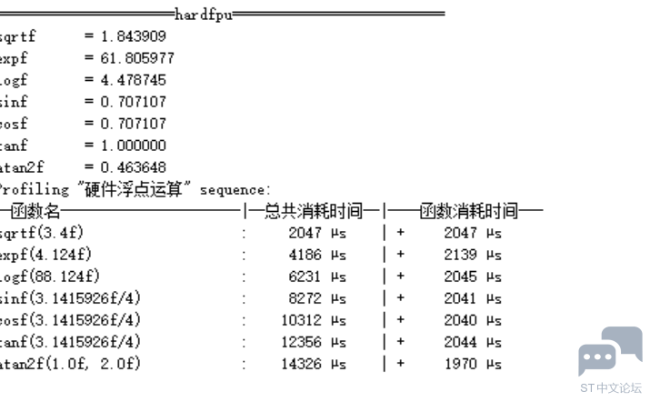

串口打印输出
6。两者进行对比
发现qfplib的浮点运行性能和硬件浮点运算性能相差无几,几乎达到了硬件浮点性能,这使得在M0/M0+/M1/M2等不具备硬件浮点运算的ARM内核可以运行浮点运算,非常完美的库!!!!
