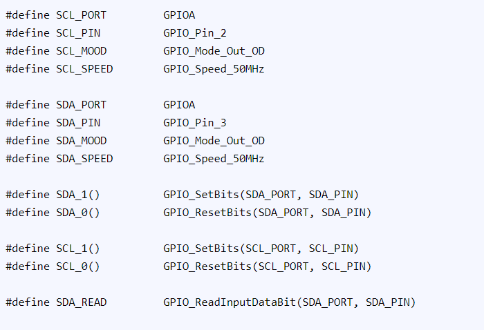

使用GPIO引脚模拟SDA和SCL总线实现软件模拟IIC通信,IIC的具体通信协议层和物理层链接:
; J4 ?$ M) {: f' u% Y
  1. #ifndef __BSP_IIC_H
    3 ?. T4 O; H2 I: x" w' R
  2. #define __BSP_IIC_H
    0 g* F$ D! G1 E* f  i% @2 K
  3. , |! L5 p. O5 r, J3 r
  4. #include "stm32f10x.h"
    & O  B8 X6 ~; c( G1 J6 ]
  5. # H1 R7 o9 f7 q
  6. / D  K  z# M8 o; p% G
  7. 0 ?' `1 e& S7 N- _2 S
  8. #define SCL_PORT         GPIOA9 p5 c8 S) q9 c
  9. #define SCL_PIN          GPIO_Pin_27 T( j4 E- m1 a
  10. #define SCL_MOOD         GPIO_Mode_Out_OD$ c+ z$ r! O: A
  11. #define SCL_SPEED        GPIO_Speed_50MHz
    / K! c9 `# _! c4 n5 I2 I
  12. + Y+ [9 d: S- }) t3 ?, S. Q* k
  13. #define SDA_PORT         GPIOA
    & T* g% o0 d+ W. V. J7 ?' O4 i7 |
  14. #define SDA_PIN          GPIO_Pin_3
    ( x$ I5 {5 X6 D% S1 n# x4 _( U
  15. #define SDA_MOOD         GPIO_Mode_Out_OD
    4 p# s! a8 p) o' X( L7 E2 R
  16. #define SDA_SPEED        GPIO_Speed_50MHz
    6 Q' q0 x4 J5 g/ L% |
  17. & y- f" ~3 T; C% l& V
  18. #define SDA_1()          GPIO_SetBits(SDA_PORT, SDA_PIN)
    / Z- q, e3 \- x) C8 x% F
  19. #define SDA_0()          GPIO_ResetBits(SDA_PORT, SDA_PIN)7 P4 M. H% S: \1 g8 h
  20. 6 `- m8 l+ P% I7 ~, O% L  `' F8 i
  21. #define SCL_1()          GPIO_SetBits(SCL_PORT, SCL_PIN)+ R$ x( F/ q  n. I
  22. #define SCL_0()          GPIO_ResetBits(SCL_PORT, SCL_PIN)( |& Z. C4 u( o
  23. ! h# [$ r5 U  g* ~0 C
  24. #define SDA_READ         GPIO_ReadInputDataBit(SDA_PORT, SDA_PIN)* T% ^* o  [! Z5 `
  25. ! Z- u# r3 N) Z# B
