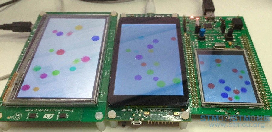

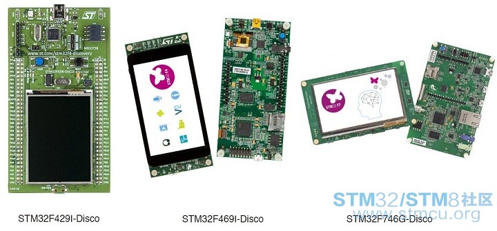

To do so, I will use GNAT GPL for ARM ELF and 3 boards of the same family: the STM32F429I-Discovery, the STM32F469I-Discovery, and the STM32F746G-Discovery.
These boards are interesting because:
  • They're fun to use, with lots of components to play with (exact features depends on the board): LCD, touch panel, audio in/out, SD-Card support, Networking, etc.
  • They are pretty cheap.
  • They are from the same manufacturer, so we can expect some reuse in terms of drivers.
  • The first one (STM32F429I-Disco) is already supported by default by the GNAT run-time. We can start from there to add support for the other boards.
  • They differ enough to deserve specific run-time adjustments, while sharing the same architecture (ARMv7) and DSP/FPU (Cortex-M4 & M7)2 o& P" w% c" n2 \, Z" _! p  W

% Z8 a! P! Y; |# V6 t- W/ @1 Y6 x stm32-disco.jpg
! a' n$ J! D6 @7 n6 T, p% I7 P! v$ J9 k4 ^) X
Photo © STMicroelectronics

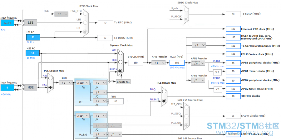

The run-time is responsible for initializing the system clock. We need the following information to do this - the various clock settings that are available, and the main clock source.
STMicroelectonics provides a Windows tool to help set up their MCU: STM32CubeMX. Using the tool we can verify the clock settings:
1 ?& Q7 [3 F$ ?3 F( Q* ]
% G5 x: {2 W& o/ ~  v3 d6 S/ L; o. g7 d% T8 N: [7 V* j0 }2 ~
Clock configuration in STM32CubeMX
To properly setup the values, we now need to check the speed of the HSE clock on the board. So back to st.com, search for STM32F469-Disco, and from the product page, download the board's user manual UM1932: Discovery kit with STM32F469NI MCU. From chapter "6.3.1 HSE clock source" check that the HSE clock is running at 8MHz.

* {5 M" N, a0 }* s. s
  1. <font face="Verdana"> Clock_Frequency : constant := 180_000_000;
    + ^# `# \2 W/ V9 C
  2.    pragma Assert (Clock_Frequency in STM32F4.RCC.SYSCLK_Range);</font>
' b, _8 K6 V, f6 H
Looking now at setup_pll.adb, we can verify that this file does not require specific changes. PLLM is set to 8 to achieve a 1 MHz input clock. PLLP is a constant to 2, so PLLN is evaluated to 360 to achieve the expected clock speed : HSE / PLLM * PLLN / PLLP = 180 MHz.
5 x+ h& [- H2 G1 {3 u- n' ?5 g
GNAT on the three boards7 U  t# ~6 a1 r) N8 L2 w
