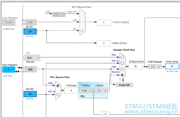

wenyangzeng 回答时间:2018-11-15 09:43:10
dashiz 发表于 2018-11-14 22:27
这个程序是前人写的,我作为新手拿过来学习的。所以又很多不懂的地方。
请问,你说的手动配置是怎么配置的 ...
上图就是手动配置为HSE,但是晶振要使用4M.
  1. void SystemClock_Config(void)
  2. {
  3.   RCC_OscInitTypeDef RCC_OscInitStruct;
  4.   RCC_ClkInitTypeDef RCC_ClkInitStruct;
  5.     /**Configure the main internal regulator output voltage
  6.     */
  7.   __HAL_PWR_VOLTAGESCALING_CONFIG(PWR_REGULATOR_VOLTAGE_SCALE1);
  8.     /**Initializes the CPU, AHB and APB busses clocks
  9.     */
  10.   RCC_OscInitStruct.OscillatorType = RCC_OSCILLATORTYPE_HSE;
  11.   RCC_OscInitStruct.HSEState = RCC_HSE_ON;
  12.   RCC_OscInitStruct.PLL.PLLState = RCC_PLL_ON;
  13.   RCC_OscInitStruct.PLL.PLLSource = RCC_PLLSOURCE_HSE;
  14.   RCC_OscInitStruct.PLL.PLLMUL = RCC_PLL_MUL16;
  15.   RCC_OscInitStruct.PLL.PLLDIV = RCC_PLL_DIV2;
  16.   if (HAL_RCC_OscConfig(&RCC_OscInitStruct) != HAL_OK)
  17.   {
  18.     _Error_Handler(__FILE__, __LINE__);
  19.   }
  20.     /**Initializes the CPU, AHB and APB busses clocks
  21.     */
  22.   RCC_ClkInitStruct.ClockType = RCC_CLOCKTYPE_HCLK|RCC_CLOCKTYPE_SYSCLK
  23.                               |RCC_CLOCKTYPE_PCLK1|RCC_CLOCKTYPE_PCLK2;
  24.   RCC_ClkInitStruct.SYSCLKSource = RCC_SYSCLKSOURCE_PLLCLK;
  25.   RCC_ClkInitStruct.AHBCLKDivider = RCC_SYSCLK_DIV1;
  26.   RCC_ClkInitStruct.APB1CLKDivider = RCC_HCLK_DIV1;
  27.   RCC_ClkInitStruct.APB2CLKDivider = RCC_HCLK_DIV1;
  28.   if (HAL_RCC_ClockConfig(&RCC_ClkInitStruct, FLASH_LATENCY_1) != HAL_OK)
  29.   {
  30.     _Error_Handler(__FILE__, __LINE__);
  31.   }
  32.     /**Configure the Systick interrupt time
  33.     */
  34.   HAL_SYSTICK_Config(HAL_RCC_GetHCLKFreq()/1000);
  35.     /**Configure the Systick
  36.     */
  37.   HAL_SYSTICK_CLKSourceConfig(SYSTICK_CLKSOURCE_HCLK);
  38.   /* SysTick_IRQn interrupt configuration */
  39.   HAL_NVIC_SetPriority(SysTick_IRQn, 0, 0);
  40. }
