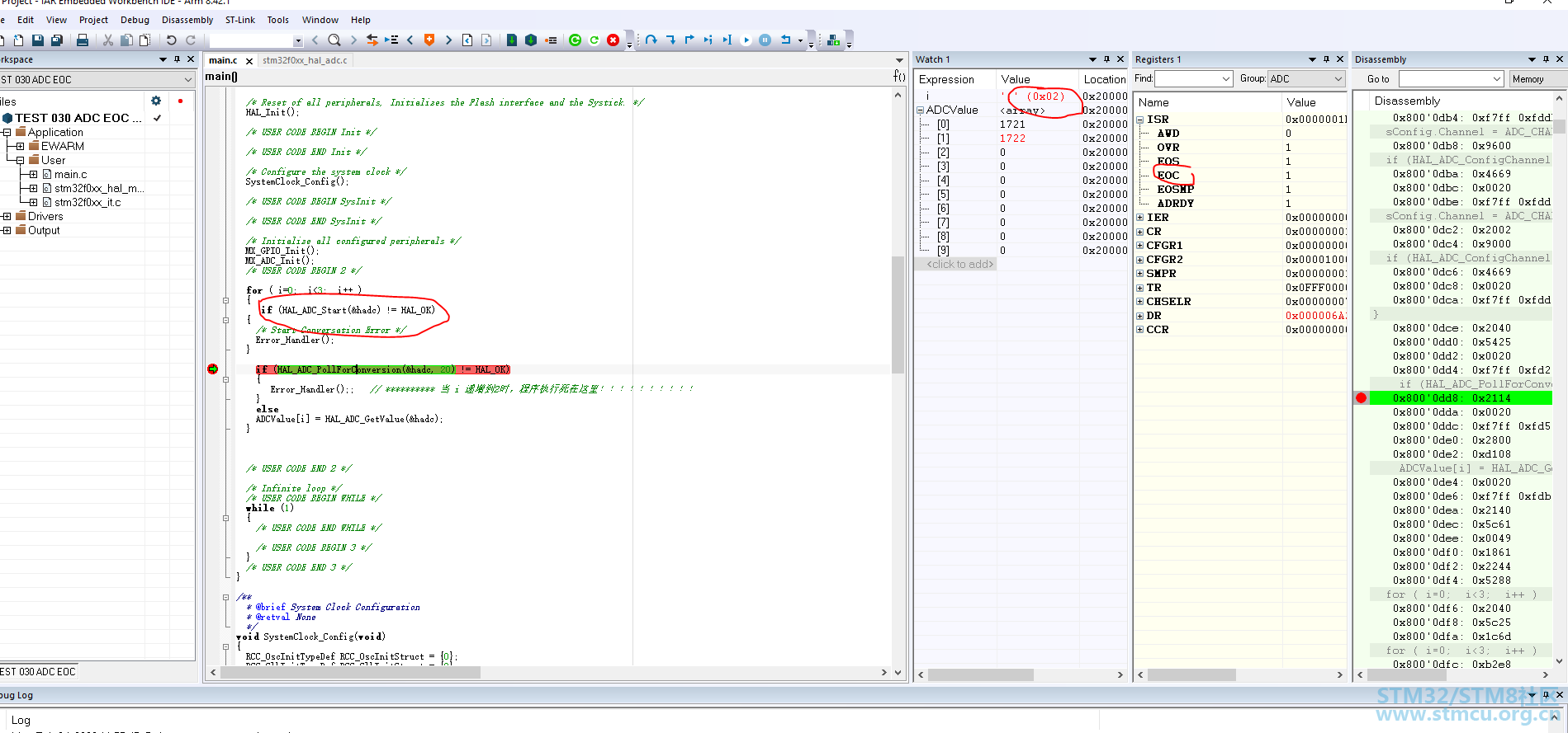

STM32F030 ADC采样序列中包括IN0,IN1,IN2三个通道,采用单次转换模式,软件触发启动,但是发现采样转换到最后一个通道IN2时,EOC不会置位,程序进入超时状态。有哪位朋友碰到过此问题?主要代码如下: uint16_t ADCValue[3; void MX_ADC_Init(void) { ADC_ChannelConfTypeDef sConfig; hadc.Instance = ADC1; hadc.Init.ClockPrescaler = ADC_CLOCK_ASYNC_DIV1; hadc.Init.Resolution = ADC_RESOLUTION_12B; hadc.Init.DataAlign = ADC_DATAALIGN_RIGHT; hadc.Init.ScanConvMode = ADC_SCAN_DIRECTION_FORWARD; hadc.Init.EOCSelection = ADC_EOC_SINGLE_CONV; hadc.Init.LowPowerAutoWait = DISABLE; hadc.Init.LowPowerAutoPowerOff = DISABLE; hadc.Init.ContinuousConvMode = DISABLE; hadc.Init.DiscontinuousConvMode = DISABLE; hadc.Init.ExternalTrigConv = ADC_SOFTWARE_START; hadc.Init.ExternalTrigConvEdge = ADC_EXTERNALTRIGCONVEDGE_NONE; hadc.Init.DMAContinuousRequests = DISABLE; hadc.Init.Overrun = ADC_OVR_DATA_PRESERVED; if (HAL_ADC_Init(&hadc) != HAL_OK) { _Error_Handler(__FILE__, __LINE__); } sConfig.Channel = ADC_CHANNEL_0; sConfig.Rank = ADC_RANK_CHANNEL_NUMBER; sConfig.SamplingTime = ADC_SAMPLETIME_7CYCLES_5; if (HAL_ADC_ConfigChannel(&hadc, &sConfig) != HAL_OK) { _Error_Handler(__FILE__, __LINE__); } sConfig.Channel = ADC_CHANNEL_1; if (HAL_ADC_ConfigChannel(&hadc, &sConfig) != HAL_OK) { _Error_Handler(__FILE__, __LINE__); } sConfig.Channel = ADC_CHANNEL_2; if (HAL_ADC_ConfigChannel(&hadc, &sConfig) != HAL_OK) { _Error_Handler(__FILE__, __LINE__); } } void Get_ADCVal(void) { uint8_t i; if (HAL_ADC_Start(&hadc) != HAL_OK) { _Error_Handler(__FILE__, __LINE__); } for ( i=0; i<3; i++ ) { if (HAL_ADC_PollForConversion(&hadc, 20) != HAL_OK) _Error_Handler(__FILE__, __LINE__); // ********** 当 i 递增到2时,程序执行死在这里!!!!!!!!!! else ADCValue[i = HAL_ADC_GetValue(&hadc); } // HAL_ADC_Stop(&hadc); } |
| 看起来ADC的转换模式是单次的,所以第二次的转换是没有启动,也就没有EOC。 把ADC的启动放到FOR 循环里就正确了 |
