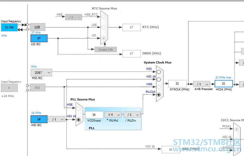

wenyangzeng 回答时间:2020-4-15 09:43:08
这片L011我使用过,没什么问题。应该是楼主的系统时钟未正确配置,仿真时使用了STLINK上的时钟。在cubemx中仔细配置一下使用内部时钟应该可以。
  1. void SystemClock_Config(void)
  2. {
  3.   RCC_OscInitTypeDef RCC_OscInitStruct;
  4.   RCC_ClkInitTypeDef RCC_ClkInitStruct;
  5.   RCC_PeriphCLKInitTypeDef PeriphClkInit;
  6.     /**Configure the main internal regulator output voltage
  7.     */
  8.   __HAL_PWR_VOLTAGESCALING_CONFIG(PWR_REGULATOR_VOLTAGE_SCALE1);
  9.     /**Initializes the CPU, AHB and APB busses clocks
  10.     */
  11.   RCC_OscInitStruct.OscillatorType = RCC_OSCILLATORTYPE_HSI;
  12.   RCC_OscInitStruct.HSIState = RCC_HSI_ON;
  13.   RCC_OscInitStruct.HSICalibrationValue = 16;
  14.   RCC_OscInitStruct.PLL.PLLState = RCC_PLL_ON;
  15.   RCC_OscInitStruct.PLL.PLLSource = RCC_PLLSOURCE_HSI;
  16.   RCC_OscInitStruct.PLL.PLLMUL = RCC_PLLMUL_4;
  17.   RCC_OscInitStruct.PLL.PLLDIV = RCC_PLLDIV_2;
  18.   if (HAL_RCC_OscConfig(&RCC_OscInitStruct) != HAL_OK)
  19.   {
  20.     _Error_Handler(__FILE__, __LINE__);
  21.   }
  22.     /**Initializes the CPU, AHB and APB busses clocks
  23.     */
  24.   RCC_ClkInitStruct.ClockType = RCC_CLOCKTYPE_HCLK|RCC_CLOCKTYPE_SYSCLK
  25.                               |RCC_CLOCKTYPE_PCLK1|RCC_CLOCKTYPE_PCLK2;
  26.   RCC_ClkInitStruct.SYSCLKSource = RCC_SYSCLKSOURCE_PLLCLK;
  27.   RCC_ClkInitStruct.AHBCLKDivider = RCC_SYSCLK_DIV1;
  28.   RCC_ClkInitStruct.APB1CLKDivider = RCC_HCLK_DIV1;
  29.   RCC_ClkInitStruct.APB2CLKDivider = RCC_HCLK_DIV1;
  30.   if (HAL_RCC_ClockConfig(&RCC_ClkInitStruct, FLASH_LATENCY_1) != HAL_OK)
  31.   {
  32.     _Error_Handler(__FILE__, __LINE__);
  33.   }
  34.   PeriphClkInit.PeriphClockSelection = RCC_PERIPHCLK_USART2;
  35.   PeriphClkInit.Usart2ClockSelection = RCC_USART2CLKSOURCE_PCLK1;
  36.   if (HAL_RCCEx_PeriphCLKConfig(&PeriphClkInit) != HAL_OK)
  37.   {
  38.     _Error_Handler(__FILE__, __LINE__);
  39.   }
  40.     /**Configure the Systick interrupt time
  41.     */
  42.   HAL_SYSTICK_Config(HAL_RCC_GetHCLKFreq()/1000);
  43.     /**Configure the Systick
  44.     */
  45.   HAL_SYSTICK_CLKSourceConfig(SYSTICK_CLKSOURCE_HCLK);
  46.   /* SysTick_IRQn interrupt configuration */
  47.   HAL_NVIC_SetPriority(SysTick_IRQn, 0, 0);
  48. }
