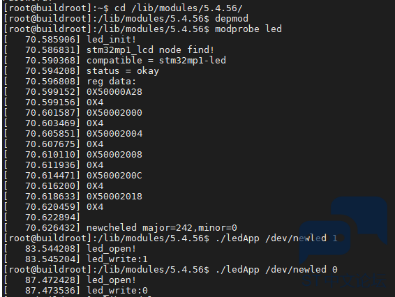

newchrled.nd =of_find_node_by_path("/stm32mp1_led");
获取 compatible 属性内容:
proper = of_find_property(newchrled.nd,"compatible", NULL);
获取 status 属性内容
ret = of_property_read_string(newchrled.nd,"status", &str);
获取 reg 属性内容
ret =of_property_read_u32_array(newchrled.nd, "reg", regdata, 12);
获取这四个内容后进行映射:
MPU_AHB4_PERIPH_RCC_PI= of_iomap(newchrled.nd, 0);
       GPIOI_MODER_PI= of_iomap(newchrled.nd, 1);
       GPIOI_OTYPER_PI= of_iomap(newchrled.nd, 2);
       GPIOI_OSPEEDR_PI= of_iomap(newchrled.nd, 3);
       GPIOI_PUPDR_PI= of_iomap(newchrled.nd, 4);
       GPIOI_BSRR_PI= of_iomap(newchrled.nd, 5);
程序的其他内容不变。
