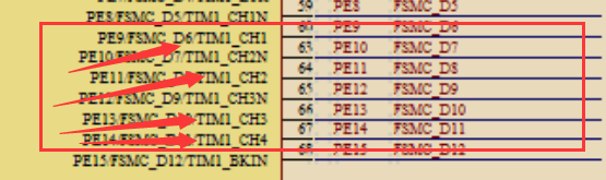

大概思路& Q& w, N; c& Z. @# J, W
1.利用定时器产生可控方波(选好定时器及通道),需要注意的是设置PWM输出引脚时要将引脚复用到定时器3 }$ Z, \/ A2 t) [
2.将电机控制引脚设置成推挽输出模式# Q/ a2 E4 }8 ~1 ?) ]' p- V. d9 T
3.改变占空比即可改变速度2 _" N/ T2 M2 ?6 e% P6 W
4.采用的电机驱动为TB6612,这里不做介绍; B5 e$ z- x% j6 m2 v# ]
5.我这里用的是定时器1的通道1,2,3,4。可自行修改6 b3 N3 J1 B3 ?' R" g
" `5 n& u# y8 Q8 h% ~6 O# c9 _9 G" H* E0 _' V$ g( o

定时器初始化
+ R- }! b4 [  v0 Y# w& W定时器1初始化' _1 v) o+ {" _* K4 S' ?

  12.         GPIO_PinAFConfig(GPIOE,GPIO_PinSource9,GPIO_AF_TIM1);
    * Z6 y# Z+ ^5 @3 f4 b9 ^7 W: E
  13.         GPIO_PinAFConfig(GPIOE,GPIO_PinSource11,GPIO_AF_TIM1);
    % S' x6 j6 V+ n7 Z' H
  14.         GPIO_PinAFConfig(GPIOE,GPIO_PinSource13,GPIO_AF_TIM1); //GPIOE9,E11,E13,E14复用为定时器1
    7 C8 R( p! x0 @! K8 E! u3 T6 m: v
  15.         GPIO_PinAFConfig(GPIOE,GPIO_PinSource14,GPIO_AF_TIM1);! H+ a9 }' H  D; @
  16.         , l& g7 n, R* b
  17.         GPIO_InitStructure.GPIO_Pin = GPIO_Pin_9|GPIO_Pin_11|GPIO_Pin_13|GPIO_Pin_14;           //GPIOF9* L3 h6 n7 X0 a$ ~; R  }/ T
