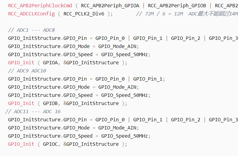

  7.     RCC_APB2PeriphClockCmd ( RCC_APB2Periph_GPIOA | RCC_APB2Periph_GPIOB | RCC_APB2Periph_GPIOC | RCC_APB2Periph_ADC1 | RCC_APB2Periph_AFIO, ENABLE );
    " F  N5 ]. i6 B) \
  8.     RCC_ADCCLKConfig ( RCC_PCLK2_Div6 );                // 72M / 6 = 12M  ADC最大不能超过14M
    0 j  H; r" I" J! B" H" G/ P6 I
  9. $ i# Z7 L0 M/ v
  10.     // ADC1 --- ADC8
      s/ ]. C  V* [; E5 F- L
  11.     GPIO_InitStructure.GPIO_Pin = GPIO_Pin_0 | GPIO_Pin_1 | GPIO_Pin_2 | GPIO_Pin_3 | GPIO_Pin_4 | GPIO_Pin_5 | GPIO_Pin_6 | GPIO_Pin_7;
    1 B. c2 C" `& z' |2 G# N
  12.     GPIO_InitStructure.GPIO_Mode = GPIO_Mode_AIN;; i+ o) g% O9 [2 w
  13.     GPIO_InitStructure.GPIO_Speed = GPIO_Speed_50MHz;
    " o% \, z, @9 Q5 W& G" t
  14.     GPIO_Init ( GPIOA, &GPIO_InitStructure );
    8 p2 F4 W5 C: _3 j  Q
  15.     // ADC9 ADC10' ?# o8 p# _0 M# P* X
  16.     GPIO_InitStructure.GPIO_Pin = GPIO_Pin_0 | GPIO_Pin_1;
    8 g, ^" \8 ~) |" q# s+ I8 J
  17.     GPIO_InitStructure.GPIO_Mode = GPIO_Mode_AIN;! Z, [; c1 n$ x7 H* h3 Z: s6 h* O
  18.     GPIO_InitStructure.GPIO_Speed = GPIO_Speed_50MHz;
      @) g4 r4 t  |
  19.     GPIO_Init ( GPIOB, &GPIO_InitStructure );
    + Y1 c: A' v' r, m$ E0 e
  20.    // ADC11 --- ADC 16
    ) u$ O0 ~2 E3 |$ d; p, I: m
  21.     GPIO_InitStructure.GPIO_Pin = GPIO_Pin_0 | GPIO_Pin_1 | GPIO_Pin_2 | GPIO_Pin_3 | GPIO_Pin_4 | GPIO_Pin_5;" E3 b4 ^2 P9 Q; L( w
  22.     GPIO_InitStructure.GPIO_Mode = GPIO_Mode_AIN;# Y" A9 J% X, w0 J
  23.     GPIO_InitStructure.GPIO_Speed = GPIO_Speed_50MHz;
    1 {6 n0 }8 O4 D1 _4 q+ ?& A( x
  24.     GPIO_Init ( GPIOC, &GPIO_InitStructure );! |. B. R/ y  b: \

ADC设置为扫描模式,连续转换,16个通道依次扫描采样,一轮采样结束后,接着开启下一轮采样。
