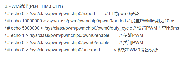

2.PWM输出(PB4, TIM3 CH1)* I, v& U4 ~2 P: m6 P
/ # echo 0 > /sys/class/pwm/pwmchip0/export        // 申请pwm0设备4 m* H: {7 W0 N& k/ e, z
/ # echo 10000000 > /sys/class/pwm/pwmchip0/pwm0/period // 设置PWM周期为10ms
; E# @( x) v% U/ # echo 5000000 > /sys/class/pwm/pwmchip0/pwm0/duty_cycle // 设置PWM占空比5ms* \$ U9 W# F  l! t
/ # echo 1 > /sys/class/pwm/pwmchip0/pwm0/enable        // 使能PWM" i: X9 F9 G9 M/ L" r3 q( t
/ # echo 0 > /sys/class/pwm/pwmchip0/pwm0/enable        // 关闭PWM& T3 K! c9 y9 ~, d
/ # echo 0 > /sys/class/pwm/pwmchip0/unexport           // 释放PWM0设备资源
