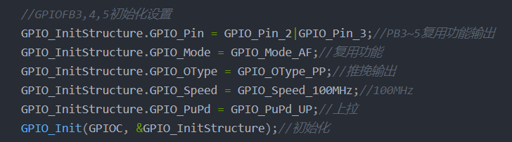

【经验分享】STM32驱动AT25640,带源码
STMCU小助手 发布时间:2022-4-22 22:00
  1. #include "eeprom.h"" F5 J5 t, P" D2 d6 \4 H
  2. 3 K! V0 J, G7 k/ r1 L
  3. - w  [: V7 w( f2 W9 D; Z0 L
  4. void eeprom_init()
    ! n7 {" p( y- \, G; y& w4 M- e
  5. {& n. P( r4 Y. Z2 g
  6.         GPIO_InitTypeDef  GPIO_InitStructure;
    ) B/ B/ C# ]' J# ^; w8 B" J+ ~
  7.         SPI_InitTypeDef  SPI_InitStructure;+ v4 P' w; }6 W5 M/ F: j0 t% i
  8. ) q. _* m3 D& z  o5 {$ G
  9.         RCC_AHB1PeriphClockCmd(RCC_AHB1Periph_GPIOB|RCC_AHB1Periph_GPIOC|RCC_AHB1Periph_GPIOE, ENABLE);//使能GPIOB时钟3 P8 }, {: c( j7 \3 S
  10.         RCC_APB1PeriphClockCmd(RCC_APB1Periph_SPI2, ENABLE);//使能SPI1时钟
    " c# {# r) ]' j+ Y9 m0 g+ o
  11. & K% ~3 {7 b  w2 J0 }' p- S
  12.         //GPIOFB3,4,5初始化设置
    1 K- m$ a4 S7 L
  13.         GPIO_InitStructure.GPIO_Pin = GPIO_Pin_2|GPIO_Pin_3;//PB3~5复用功能输出        5 m  g% Q+ {" L
  14.         GPIO_InitStructure.GPIO_Mode = GPIO_Mode_AF;//复用功能2 J% d% D& B; a  n+ m1 s
  15.         GPIO_InitStructure.GPIO_OType = GPIO_OType_PP;//推挽输出: T! H5 D& o) ~5 x
  16.         GPIO_InitStructure.GPIO_Speed = GPIO_Speed_100MHz;//100MHz0 \/ U) p% x0 Y  B! j' Q/ B% r- h# U7 ^6 J
  17.         GPIO_InitStructure.GPIO_PuPd = GPIO_PuPd_UP;//上拉) d& S, q; m* P2 n* v; p
  18.         GPIO_Init(GPIOC, &GPIO_InitStructure);//初始化
      h5 p2 p" X$ f/ W0 l. }9 S
  19.         5 U; P( y$ [# F1 f) O5 }
  20.         //GPIOFB3,4,5初始化设置; L  W& V5 L" p& S
  21.         GPIO_InitStructure.GPIO_Pin = GPIO_Pin_10;//PB3~5复用功能输出
    ; \6 n5 v& ~) R3 u  \3 L1 c$ C
  22.         GPIO_InitStructure.GPIO_Mode = GPIO_Mode_AF;//复用功能. D+ Y4 s7 {0 j) W# M
  23.         GPIO_InitStructure.GPIO_OType = GPIO_OType_PP;//推挽输出
    6 w# q( b7 l; _
  24.         GPIO_InitStructure.GPIO_Speed = GPIO_Speed_100MHz;//100MHz
    , f" ^) O" E9 l- v* _
  25.         GPIO_InitStructure.GPIO_PuPd = GPIO_PuPd_UP;//上拉! r. A8 B: o1 z1 o# v( \- b2 p! i
  26.         GPIO_Init(GPIOB, &GPIO_InitStructure);//初始化        + Z1 V" C. m% A, `, @: I  `
  27.         , u; v5 j( G& ?0 ^) j
  28.         //GPIOFB3,4,5初始化设置
    / M3 A( |# H3 J% y8 R
  29.         GPIO_InitStructure.GPIO_Pin = GPIO_Pin_2|GPIO_Pin_3;//PB3~5复用功能输出        0 i( U$ E2 v& u' o5 p% R% I* }' Y- r
  30.         GPIO_InitStructure.GPIO_Mode = GPIO_Mode_OUT;//复用功能- W( c* @0 c3 a) L) K) |7 B& X
  31.         GPIO_InitStructure.GPIO_OType = GPIO_OType_PP;//推挽输出, _. t6 s( d. P' D! K
  32.         GPIO_InitStructure.GPIO_Speed = GPIO_Speed_100MHz;//100MHz6 T- J* B0 P& T1 b
  33.         GPIO_InitStructure.GPIO_PuPd = GPIO_PuPd_UP;//上拉
    / V% \$ F% |' ?$ n, D
  34.         GPIO_Init(GPIOE, &GPIO_InitStructure);//初始化        ! L0 \" u4 ~3 d9 i0 y
  35.         GPIO_SetBits(GPIOE,GPIO_Pin_2|GPIO_Pin_3);        7 D7 e- W% H; o# j2 \- Y: w$ k
