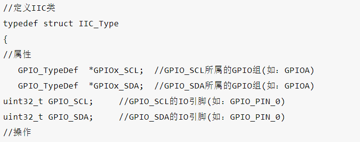

    iic.h头文件主要是类模板的定义,具体如下:
  1. //定义IIC类9 v) ^3 a# U  j3 i( t
  2. typedef struct IIC_Type
    , e5 A7 H3 G6 {7 e% L6 V# ?
  3. {
      `7 N7 `% G; X' k; _( e/ U/ y
  4. //属性
    # w2 R$ G2 D9 U7 ?7 u, I
  5.    GPIO_TypeDef  *GPIOx_SCL;  //GPIO_SCL所属的GPIO组(如:GPIOA)
    . \, Z8 _+ E% q7 B. m7 z
  6.    GPIO_TypeDef  *GPIOx_SDA;  //GPIO_SDA所属的GPIO组(如:GPIOA)/ w( E7 }. P" F1 ~) y0 F
  7. uint32_t GPIO_SCL;     //GPIO_SCL的IO引脚(如:GPIO_PIN_0)! Q0 d; n2 Z1 n. G
  8. uint32_t GPIO_SDA;     //GPIO_SDA的IO引脚(如:GPIO_PIN_0)
    & b: F+ g; \9 o: @2 n7 o" p
