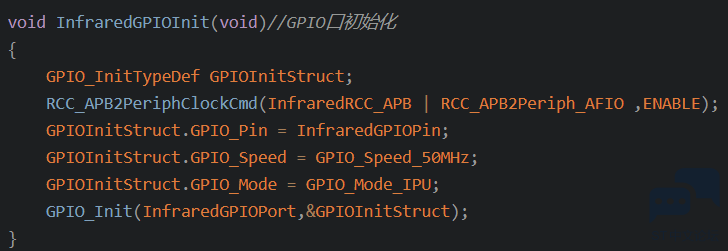

2 g6 J- w: U/ _% e2.GPIO初始化! j9 |) P2 @  R  N3 b; Y
  1. void InfraredGPIOInit(void)//GPIO口初始化
    / k; Q1 s& T5 h7 `
    $ `0 {1 N8 H/ {& f% N
  3.     GPIO_InitTypeDef GPIOInitStruct;
    ; h0 n8 z5 O6 e
  4.     RCC_APB2PeriphClockCmd(InfraredRCC_APB | RCC_APB2Periph_AFIO ,ENABLE); //开启时钟  RCC_APB2Periph_AFIO
    " O/ ]9 Y# P) ~% u. ~+ n
  5.     GPIOInitStruct.GPIO_Pin = InfraredGPIOPin;
    % ?  a3 t, }  ^
  6.     GPIOInitStruct.GPIO_Speed = GPIO_Speed_50MHz;% U$ h9 W& Q' B2 }
  7.     GPIOInitStruct.GPIO_Mode = GPIO_Mode_IPU;( Z6 \' m; k; C# y1 P
  8.     GPIO_Init(InfraredGPIOPort,&GPIOInitStruct);3 A+ U: h. Q; ?- {0 b4 o2 m0 S
  9. }
