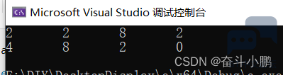

+ y. v6 L4 |/ r) V* B# J4.测试结果展示* \/ j2 V+ `. {0 r/ y
' F) ^5 C- k! W6 J' g3 o! `8 p# h4 I 9cad061d212f444caed06d6622767e14.png   @; z) G9 L5 h; x" S
3 p* }5 t1 k& P# ~" p$ x& f: _8 E4 z2 Y
8 Q9 u. R' v- L3 g) Q$ O1 A' s0 M 8dd60d7867084c48b240887a90cf5531.png : y: V1 g0 ?( \6 l
0 q8 {; [* l% p 18f931e61ce14bf0989fbb4f935d9c4f.png ! k2 c6 ]6 b% g/ |
) s4 \3 P2 O# Y- d
