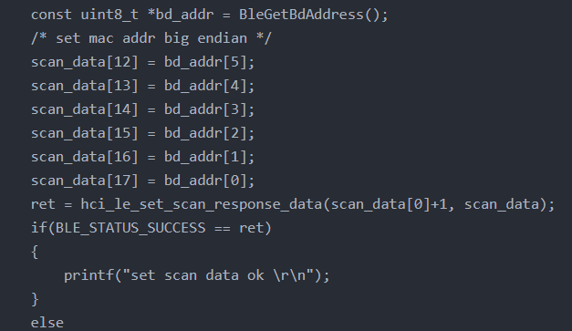

  1.         const uint8_t *bd_addr = BleGetBdAddress();
    . Y7 O' R2 g4 s! y9 S
  2.         /* set mac addr big endian */0 n$ M. @6 R6 j1 k
  3.         scan_data[12] = bd_addr[5];
    ) C+ q' `; X+ R; ?" H
  4.         scan_data[13] = bd_addr[4];/ Y1 N8 x- c: i9 ]: i
  5.         scan_data[14] = bd_addr[3];& k2 O. z9 P" C% h2 v
  6.         scan_data[15] = bd_addr[2];
    1 L/ y9 ^+ ?  X6 ~# ~
  7.         scan_data[16] = bd_addr[1];6 k% u4 B: G% H/ j
  8.         scan_data[17] = bd_addr[0];
    % \! t6 D' g) d  w: Q& Y9 J' {# u
  9.         ret = hci_le_set_scan_response_data(scan_data[0]+1, scan_data);2 J0 H) H0 O' \- u1 B% p
  10.         if(BLE_STATUS_SUCCESS == ret)
    : G" _- o4 u" k# I6 f
  11.         {6 c" p  s! s8 ^
  12.                 printf("set scan data ok \r\n");7 ~. R: S! W% ~4 B& T- z
  13.         }
    8 o6 h, Q3 G0 z5 T" ^5 T3 D& Z5 r
  14.         else
    . U7 n7 Q1 M# z7 V6 i& M4 d
  15.         {9 ?& E9 Z5 m; D* X) C0 ?
  16.                 printf("set scan data fail \r\n");
    . w0 k/ S2 k2 a
  17.         }
    5 D$ U5 u$ Z4 B5 O! s% A
  18. }: m! ^) g& B' U% l. M, N
