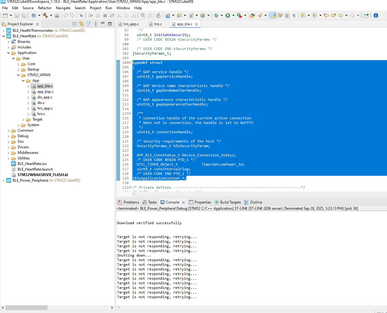

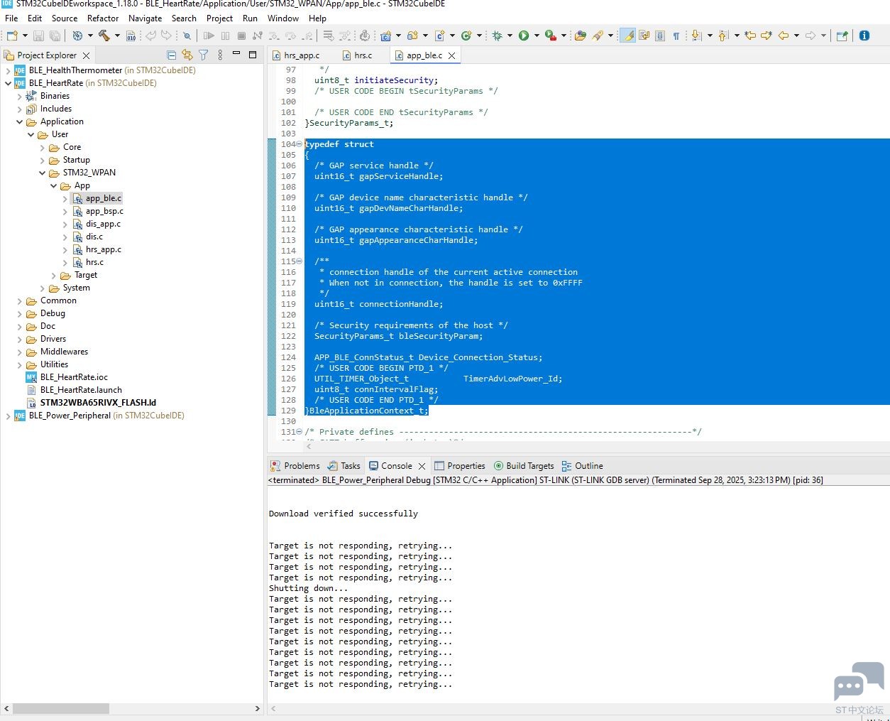

在蓝牙NUCLEO-WBA65RI开发中,st提供了完整的开发框架和逻辑,而对于开发的过程,需要围绕BleApplicationContext_t这个结构体的访问控制来实现的。
这里定义的结构体
typedef struct
  /* GAP service handle */
  uint16_t gapServiceHandle;
  /* GAP device name characteristic handle */
  uint16_t gapDevNameCharHandle;
  /* GAP appearance characteristic handle */
  uint16_t gapAppearanceCharHandle;
   * connection handle of the current active connection
   * When not in connection, the handle is set to 0xFFFF
  uint16_t connectionHandle;
  /* Security requirements of the host */
  SecurityParams_t bleSecurityParam;
  APP_BLE_ConnStatus_t Device_Connection_Status;
  /* USER CODE BEGIN PTD_1 */
  UTIL_TIMER_Object_t           TimerAdvLowPower_Id;
  uint8_t connIntervalFlag;
  /* USER CODE END PTD_1 */
}BleApplicationContext_t;
