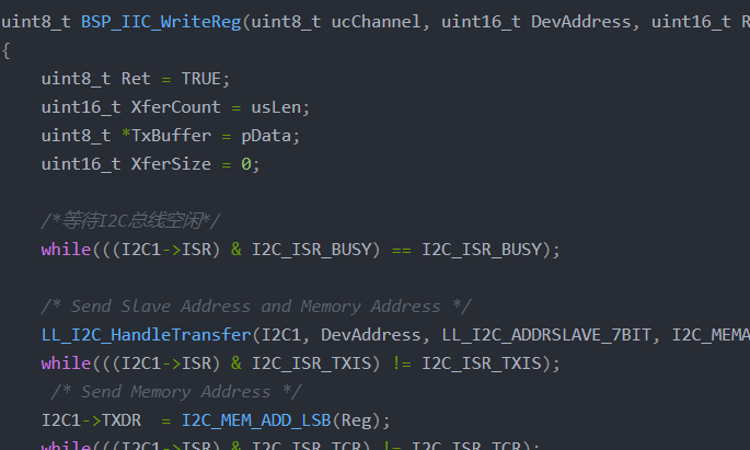

攻城狮Melo 发布时间:2022-11-4 15:49
HAL库底层中有超时返回函数,在这里精简掉,此函数验证与STM32L0,其他板子未验证,ulTimeout 参数无用,可直接写0- d& A# m" k8 x0 M. m7 x: P
% K5 b+ V) a, I3 b5 I; u写寄存器9 e9 R2 c* q* D0 c! i! k4 `
# d; A. W. U) [
  1. uint8_t BSP_IIC_WriteReg(uint8_t ucChannel, uint16_t DevAddress, uint16_t Reg, uint8_t *pData, uint16_t usLen, uint32_t ulTimeout)
    9 V8 W: U$ k, I. @; d: I* y
  2. {9 o; _4 _$ v5 \1 b5 b( x
  3.     uint8_t Ret = TRUE;8 s6 {& l, E  C+ [( {( S) U% y
  4.     uint16_t XferCount = usLen;. X: w% F1 _, r. r5 B5 V, ~
  5.     uint8_t *TxBuffer = pData;: c2 y1 r% M8 M2 m
  6.     uint16_t XferSize = 0;, Y/ H! `# V5 X3 g/ D1 A
  7. % B! F4 A& ~7 s
  8.         /*等待I2C总线空闲*/7 C! X" N- U9 I' P6 Z% m7 W
  9.     while(((I2C1->ISR) & I2C_ISR_BUSY) == I2C_ISR_BUSY);
    ! U: z+ F+ f3 F% W! c, O
  10. 9 T( V& Y* w5 T0 u% \0 ~/ S5 c  K
  11.     /* Send Slave Address and Memory Address */% ~* `5 v% x8 t' `& B' U
  12.     LL_I2C_HandleTransfer(I2C1, DevAddress, LL_I2C_ADDRSLAVE_7BIT, I2C_MEMADD_SIZE_8BIT, I2C_CR2_RELOAD , LL_I2C_GENERATE_START_WRITE);) e' V( |; o. |, I1 w' }5 h# e' x
  13.     while(((I2C1->ISR) & I2C_ISR_TXIS) != I2C_ISR_TXIS);& S$ s% ]3 w- O; D* |
  14.          /* Send Memory Address */, Z$ G0 s! Y# p- b, J& j4 A$ O
  15.         I2C1->TXDR  = I2C_MEM_ADD_LSB(Reg);
    , e( N" M( Q' ^
  16.     while(((I2C1->ISR) & I2C_ISR_TCR) != I2C_ISR_TCR);
    ! Y' i2 A0 r' ^  p' t
  17.   `5 e: t' l! ]. C4 \! s+ T* G4 ?5 ]. X
  18.     /* Set NBYTES to write and reload if hi2c->XferCount > MAX_NBYTE_SIZE */! C( e" x- o/ g* a( G) I5 Y3 V
  19.     if (XferCount > MAX_NBYTE_SIZE)
    ) S  ]* U0 t1 }
  20.     {+ M# Z$ P8 C4 o8 L
  21.         XferSize = MAX_NBYTE_SIZE;
    4 W5 `2 E: y, G6 }& Y4 b: ~* D
  22.         LL_I2C_HandleTransfer(I2C1, DevAddress, LL_I2C_ADDRSLAVE_7BIT, (uint8_t)XferSize, I2C_CR2_RELOAD , I2C_NO_STARTSTOP);
    & `7 |: z. }% m! U0 j  z$ `4 m
  23.     }
    - J! a; n  q/ f( j/ F
  24.     else" D5 w$ n; ?4 `0 W' |  [! ]) \
  25.     {% w4 Y" G8 J) N  g
  26.         XferSize = XferCount;
    2 E- }# {2 P3 C
  27.         LL_I2C_HandleTransfer(I2C1, DevAddress, LL_I2C_ADDRSLAVE_7BIT, (uint8_t)XferSize, I2C_CR2_AUTOEND , I2C_NO_STARTSTOP);
    ) p1 n8 u$ T2 h) V& G6 ]
  28.     }4 M0 ?+ c9 ^/ T! u7 B0 o6 `  U, i. ^
  29.   z: C% o5 l9 T/ H) L
  30.     do
    ' E2 X3 N4 z8 Y$ W" R3 B" {& ?
  31.     {1 }- C& x8 h# w6 o1 W: z  p; y6 l
  32.         /* Wait until TXIS flag is set */+ Y2 s( }; @3 S1 Q. g1 ^
  33.         while(((I2C1->ISR) & I2C_ISR_TXIS) != I2C_ISR_TXIS);
    " Z1 E0 w/ a: _  j1 k
  34.         /* Write data to TXDR */6 L: M+ s0 H' f- s  w
  35.         I2C1->TXDR = *TxBuffer;+ _! s9 M6 d) f0 \8 @3 |% o9 O
  36.         /* Increment Buffer pointer */3 B& z+ M6 c4 k
  37.         TxBuffer++;% X9 X0 V/ A" i4 c, Q; x
  38. 8 M8 J9 B7 s" G1 i7 {, l$ u
  39.         XferCount--;
    % m8 |5 M4 f7 ?. q* `/ D5 i1 S
  40.         XferSize--;! H! e6 v" \" k8 B9 s# I; i
  41. 1 k9 Z$ p1 m2 B3 L- \4 b0 l
  42.         if ((XferCount != 0U) && (XferSize == 0U))0 u0 a( g4 d9 c6 E4 }5 S
  43.         {
    & _% _" s+ O( B$ z; V
  44.             /* Wait until TCR flag is set */
    . h: Y6 D2 S% i2 f% d8 G0 b
  45.             while(((I2C1->ISR) & I2C_ISR_TCR) != I2C_ISR_TCR);
    0 R) G, _/ C; p0 z
  46.
    0 u1 a5 c* K% Z0 c3 O
  47.             if (XferCount > MAX_NBYTE_SIZE)8 E* r& G5 ^* t
  48.             {: `1 N* C* ~7 k3 _
  49.                 XferSize = MAX_NBYTE_SIZE;
    4 K3 }& E5 J, e5 _4 y, y
  50.                 LL_I2C_HandleTransfer(I2C1, DevAddress, LL_I2C_ADDRSLAVE_7BIT, (uint8_t)XferSize, I2C_CR2_RELOAD , I2C_NO_STARTSTOP);
    * ?7 o- ]3 J7 \6 U7 P0 t
  51.             }& B; I& i2 t2 ?& D
  52.             else
    7 _5 P" X* V  K# X' w/ k/ Z9 e8 T
  53.             {8 I  I: B$ l9 U% k& Y
  54.                 XferSize = XferCount;
    6 `7 X, A' n* x1 O  N6 ^! ?
  55.                 LL_I2C_HandleTransfer(I2C1, DevAddress, LL_I2C_ADDRSLAVE_7BIT, (uint8_t)XferSize, I2C_CR2_AUTOEND , I2C_NO_STARTSTOP);
    2 O) j/ C1 f+ R) C
  56.             }
    , E% ?6 U! D. d, e
  57.         }4 w: e7 C. u: D& M0 q/ h/ j
  58.     }9 j( u$ Z! x+ _' I: D
  59.     while(XferCount > 0U);7 D; o7 c! T$ k2 z( H1 p& d5 U; G; X- V
  60. , H7 G3 Q! j& B6 k
  61.     /* No need to Check TC flag, with AUTOEND mode the stop is automatically generated */8 [0 t" Q" f% y: f9 P6 l) F
  62.     /* Wait until STOPF flag is reset */% l& @7 }7 n; |9 C" z
  63.     while(((I2C1->ISR) & I2C_ISR_STOPF) != I2C_ISR_STOPF);
    6 M, |) D  ?) b/ j1 N
  64. ! @! G* p2 k) g0 S( y$ q
  65.     /* Clear NACKF Flag */
    + i, `! e6 e6 n. K( O2 ?
  66.     __HAL_I2C_CLEAR_FLAG(I2C1, I2C_ISR_NACKF);8 [3 x) _; Z" s# k9 k) q  x
  67.         7 F1 O2 ?. W2 I# j3 r, _
  68.     /* Clear STOP Flag */
    4 l% G' j9 B4 d9 w
  69.     LL_I2C_ClearFlag_STOP(I2C1);# f9 x- L; [5 v" b& h$ J
  70. 0 g' P$ X% k# N
  71.     /* Clear Configuration Register 2 *// e# g& F6 t. J- h4 X
  72.     I2C1->CR2 &= (uint32_t)~((uint32_t)(I2C_CR2_SADD | I2C_CR2_HEAD10R | I2C_CR2_NBYTES | I2C_CR2_RELOAD | I2C_CR2_RD_WRN));
    ) ?" [$ y) ?# b8 D4 ?
  73. " o0 Z8 b: J' M0 I
  74.     return Ret;
    / a8 J) Y1 _$ ?, B/ K; E
  75. }
