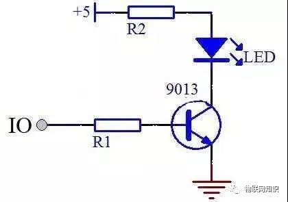

LED/ e5 u8 h0 `" r0 M7 @8 e
驱动原理定义程序 - #ifndef __LED_H
( y' U% o5 k$ Z, w - #define __LED_H! ~2 h7 ?! G: U( W6 l9 L4 H5 H
- #include "stm32f10x.h"
. h# y& n* C- ~3 v9 r' I F - #include "delay.h"
( Q( G x; Z Z+ ^ - #define LED PAout(8)
: r5 V4 k3 T* D( ? - void LED_Init(void);% z- A! g4 z7 Z+ ]
- #endif /* __LED_H */
复制代码- #include "LED.h") M# Q) I* S O" o' a3 L) O }; ~+ L
- #include "stm32f10x_gpio.h"
$ b! G% r: M' ]! Y. W7 C0 K+ o: \% t - #include "delay.h"( u# x2 x/ J3 N2 h& }! o4 b" D: a
- void LED_Init(void)1 B) f1 S4 M; s j: `$ q
- { $ n( g6 H3 q# t7 z; S
- GPIO_InitTypeDef GPIO_InitStructure;
& D& h4 U5 I$ R - RCC_APB2PeriphClockCmd(RCC_APB2Periph_GPIOA,ENABLE); //使能时钟3 q6 u2 ~9 Q+ g7 o. G
- GPIO_InitStructure.GPIO_Pin = GPIO_Pin_8;
4 E1 u$ V) o0 W( J/ i4 D - GPIO_InitStructure.GPIO_Mode = GPIO_Mode_Out_PP;
& }" P1 J, Z l8 t* m! O) z - GPIO_InitStructure.GPIO_Speed = GPIO_Speed_50MHz;: ^9 P. d# w) C! A$ l6 j
- GPIO_Init(GPIOA, &GPIO_InitStructure);0 p# N- J+ r' g0 c' u
- LED = 1;
1 V3 \( T( U# x+ N" G - }
