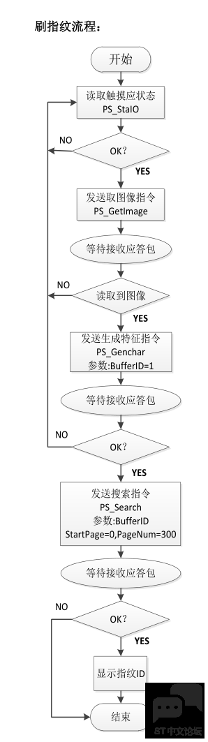

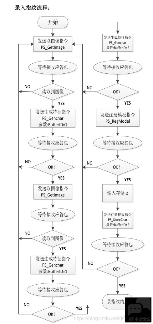

四、开发流程
1 [6 J2 g- o. Q% K, O/ `/ @  o
+ X4 j/ [7 `* r9 \ 640.png

刷指纹
* O" s% j: Z3 N
  1. void press_FR(void)
    6 L  C- u: v  p$ Z
  2. {
    7 }) K9 @* h/ E* @
  3.   SearchResult seach;
    $ \! l5 j6 U  X1 o  d1 N2 I1 r
  4.   u8 ensure;, A' U+ D' r& U6 m
  5.   ensure=PS_GetImage();
    8 l; B) ~4 }: O$ A! `; `
  6.   if(ensure==0x00)//获取图像成功
      c" w+ H% c0 o+ j- H
  7.   {
    " p, M7 G" c& M2 c( m
  8.     ensure=PS_GenChar(CharBuffer1);2 g- n9 a! z! C1 m, m
  9.     if(ensure==0x00) //生成特征成功9 F0 f% y4 D5 ^8 H& U
  10.     {
    7 E0 l1 i5 E0 v
  11.       ensure=PS_HighSpeedSearch(CharBuffer1,0,300,&seach);; M$ R# o3 v9 G3 F) m* P$ g
  12.       if(ensure==0x00)//搜索成功  |- E. U3 ^) P- c
  13.       {
    5 i# M) l+ |7 }* [
  14.         printf("search the fingerprint successfully\n");//搜索指纹成功        , N) ?% _" M& [0 ?8 y7 F2 M) }5 J+ t
  15.       6 _7 K7 k  b- C
  16.         printf("Match ID:%d  Match score:%d\n",seach.pageID,seach.mathscore);//显示匹配指纹的ID和分数9 P: c7 p/ W" O0 F& S
  17.         7 v1 e4 ]4 p0 P$ _/ h
  18.
    5 w/ ]. W) F( ], K3 q
  19.         if(seach.pageID==0)# a8 G" s. j1 ~1 u* ?0 X
  20.           LED=0;
    * A8 ]  N6 Y# e4 j9 K& C5 a
  21.       }8 Z% ~' g6 i& }/ x: {% v& W
  22.       else
    # Z5 P# h' l) D: B& V6 p' s
  23.       {0 u, g. @$ T; m# a  h/ [
  24.         printf("%c",ensure);
    ! z) ^- T- H' m4 F: R
  25.           LED=1;
    1 h  L  p( w" ?: K  ~  b
  26.       }        , `) R8 }! Q2 j! `: e( }" d0 C
  27.     }% b+ e9 b' T7 T6 f  Z
  28.     else, t# M' z  p- q2 f
  29.       printf("%c",ensure);
    1 J) c$ L* c$ x0 i$ @
  30.    delay_ms(1000);//延时后清除显示
    8 Z) C) O4 B8 R& N
  31.    printf("\n");
    $ d' H( i2 v: T8 B+ M, a$ c& m
  32.   }, u6 h, f, ?: G
  33.
    7 V3 W6 t( O2 O! R' `# m# n
  34. }
3 g5 u" |" ^7 R' S
录入指纹
8 f3 i5 G5 L0 y
  1. void Add_FR(void)( ?$ u6 V7 B1 r( g6 h- w( g
  2. {3 B# |: Z3 ~) U, l* B
  3.   u8 i=0,ensure ,processnum=0;- u& y( B8 M! E# X6 U2 K2 g
  4.   u16 ID;
    " X) m$ G8 b1 u
  5.   while(1)
    4 X  N. J: B6 e2 S4 A& L
  6.   {4 f" U: m' B8 Y) U& _8 a7 _
  7.     switch (processnum)* W4 p7 U" ]9 i% e! F$ n( O
  8.     {2 B. b1 I% d& i3 o
  9.       case 0:1 p1 }" M( U) \5 y1 `
  10.         i++;
    & n& P  L; L* J7 c0 m
  11.         printf("please finger\n");   //请按手指. [) g5 K) L% k( Z  W1 q( U- L) K
  12.         ensure=PS_GetImage();//录入图像返回字4 ^- ?( ]# I7 V3 _
  13.         if(ensure==0x00)
    # }0 ^9 G5 |6 k5 ^6 h% a
  14.         {
    1 x5 J, L9 j  b+ h
  15.           ensure=PS_GenChar(CharBuffer1);//生成特征, G4 K! a6 z) ^' w" C
  16.           if(ensure==0x00)1 o0 G/ q6 |& j6 g- o
  17.           {0 V1 X  z: F2 @
  18.             printf("zhengque\n");//指纹正确
    / h- P" d, Q- I
  19.             i=0;
      A8 N! u& w6 C7 ~
  20.             processnum=1;//跳到第二步            2 j. X, B/ K. K8 {+ A5 B& x+ W
  21.           }$ `" w, l4 ^- z" m* h. U
  22.           else printf("%c\n",ensure);
    ! J! O0 z6 `  W1 w! q
  23.         }
    4 C$ S; p2 e1 S8 C$ e. {9 r( S
  24.         else  printf("%c\n",ensure);
    6 G6 L/ y2 ^* ?
  25.         break;
    - f% b+ F0 S, Z& m- o5 d
  26.       - V+ B5 Q. K- j; t. G% O6 y: f* V
  27.       case 1:
    , }+ }# ]$ p7 K7 r
  28.         i++;
    , ]4 O$ ^, |1 B7 ?. H$ K0 b7 K
  29.          printf("please click on the finger\n");//再按一次手指* w0 \6 \( `; R
  30.         ensure=PS_GetImage();8 m% s- K/ X0 M/ `6 o
  31.         if(ensure==0x00)
    , ]& l  N' r; w/ w# H) n) y
  32.         {0 O# a: w/ x- D
  33.           ensure=PS_GenChar(CharBuffer2);//生成特征        q: |! @: _# O. A! }7 u
  34.           if(ensure==0x00)1 X3 m& b3 ?6 ]% Y3 s0 t: Q+ B
  35.           {
    ( c3 E+ y  [9 F5 _& |
  36.             printf("Fingerprint right\n");//指纹正确
    1 p' g- y* b& a/ L" G( a
  37.             i=0;. v9 J$ R) Z! a
  38.             processnum=2;//跳到第三步' A- T: v$ {0 }2 q" K. f: |5 o* r2 e
  39.           }else
    ' u2 t# n0 V, B1 D7 g
  40.           printf("%c",ensure);
    . f* B- O- w1 N; K& {4 A# s$ B
  41.         }else 0 B( y: j* x* w1 {9 a/ h
  42.         printf("%c",ensure);
      B- U  T' Q* B9 G
  43.         break;' M2 u/ A9 r' [' ^
  44.       case 2:
    1 [' _+ ]) p; V' n! H5 A5 W6 y
  45.         printf("comparing two fingerprints\n");   //对比两次指纹3 v. P' D8 I/ ]! N1 }9 C* ?
  46.         ensure=PS_Match();//精确比对两枚指纹特征返回字
    1 `! X" X8 w* R# U# m
  47.         if(ensure==0x00) 3 x! v7 w( }. k+ Y
  48.         {
    . B; i6 {# N) \0 b0 n% R
  49.           printf("Two fingerprints is the same\n");//两次指纹是一样的  [6 q/ K# t$ V: n7 |. e" p  v
  50.           processnum=3;//跳到第四步% ]" e5 K& O* L( ?( v5 K. D/ |
  51.         }- C% G; q, m4 N
  52.         else 5 t" k9 K" S- o4 i  \, ]3 `( G6 [
  53.         {6 ]& d. _/ I6 {* ]5 j
  54.           printf("Comeparative failure,please press fingers again\n");//对比失败,请重新按手指
    & ]: C4 `+ B1 ^  F+ h" X  L" m
  55.           printf("%c",ensure);" q, N8 _$ W1 ?7 C7 u8 ]
  56.           i=0;' I! R* P8 D# Q/ q
  57.           processnum=0;//跳回第一步    ; T# W) N; H2 ^* Q; j8 x% M0 t
  58.         }
    ; x% y0 ]: D% G0 U; j- `
  59.         delay_ms(1000);
    . H" g% C3 B# K- y+ j, G1 v1 C
  60.         break;
      [8 N+ P- N3 I
  61.       case 3:$ R0 q  Z3 j8 p- _  W
  62.         printf("generate a fingerprint template\n");//产生一个指纹模板
    0 p& f( I( w' k9 S7 b6 ~! ]. [
  63.         ensure=PS_RegModel();
    % p) ]" T: G2 e; {, N# i8 x; g7 r
  64.         if(ensure==0x00) - l, r4 P  M3 c" F9 H% U# Y1 P
  65.         {
    3 Y: V& i* q; j+ ^2 y- O% J. g! D
  66.           printf("generate a fingerprint template is successful\n");//生成指纹模板成功4 s; ], k" v# A3 O0 ?1 o
  67.           processnum=4;//跳到第五步
    : Y+ \( ]4 `/ E
  68.         }else {processnum=0;printf("%c",ensure);}( R9 u0 a# H7 `: K
  69.         delay_ms(1000);3 x8 X$ K" N( v/ F
  70.         break;
    2 X% y: D* p* g8 o) k
  71.         ! Q7 [* p; S" w) j5 L
  72.       case 4:
    . Q3 x9 Q. k( E% O& c2 g: I
  73.         printf("input the ID and press Enter to save\n");//输入ID并按“Enter”保存
    % \/ F9 D0 p0 Z- a' W$ W8 v
  74.         printf("0=< ID <=299\n");  + a+ {6 `) A( F4 q1 ~: @
  75.         do
    3 l. p5 [# H0 U4 l, I
  76.
    3 p# d: G. J7 K/ g# r
  77.         {! w' a3 A, \( r: }+ M2 h9 |0 \
  78.           ID++;  l: a% T0 h2 v/ k
  79.         }
    6 k! c! Y! ~" N, N
  80.         while(!(ID<300));//输入DI必须小于300/ s9 i+ e8 L" {/ t
  81.         ensure=PS_StoreChar(CharBuffer2,ID);//储存模板- n# X% Z3 g8 p# V9 J6 c
  82.         if(ensure==0x00)
    # }* v! h7 z' j. _4 @+ C* H
  83.         {
    ; R$ F3 @! C2 V& J, c8 {
  84.           printf("Add the fingerprint successfully\n");//添加指纹成功
    % \- U, ?& N& l9 _; h
  85.           PS_ValidTempleteNum(&ValidN);//读库指纹个数
    + A% o4 Q+ o: n; b- d& b
  86.
    0 R0 F! a5 S' r! j6 ]
  87.           printf("%d\n",AS608Para.PS_max-ValidN);//显示剩余指纹个数4 V+ u9 k0 i6 ?+ v" h
  88.           delay_ms(1500);//延时后清除显示
    ; T. ^, L' O+ V! Q; k
  89.           printf ("\n");
    ' w3 z. l$ J! S$ V6 a
  90.           return ;
    3 t& U0 D1 ]1 q" g8 o
  91.         }else {processnum=0; printf("%c\n",ensure);}
    0 L" k2 ]0 ^* f5 b. O
  92.         break;
    6 p: k* N# U+ \, R
  93.     }0 t4 m8 [$ i% H& t% M/ O
  94.     delay_ms(800);9 ~2 Q) x1 `! v  q2 f0 R- R
  95.     if(i==5)//超过5次没有按手指则退出9 l' j! a2 C  C$ g# U" G3 m
  96.     {- \' t5 o# M& i  G
  97.       printf("\n");2 U8 ~, C" O: v4 g
  98.       break;  ; W# h" Z( u1 T* O
  99.     }
    : d9 Q1 h8 b8 ?1 t! j
  100.   }
    + U$ k0 X& _8 X1 O/ Z
  101. }
& Q( t3 y3 {! r/ e( `
