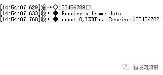

现象
7 g( d( V5 `9 OPC端发送123456789,MCU回复Receive a frame data
4 u/ N) S8 f, G/ m) {count 8,LEDTask Receive 12345678" i6 g3 B6 G+ W7 f2 O
5 T( f0 ?" @9 O9 |' U  }3 D3 R
