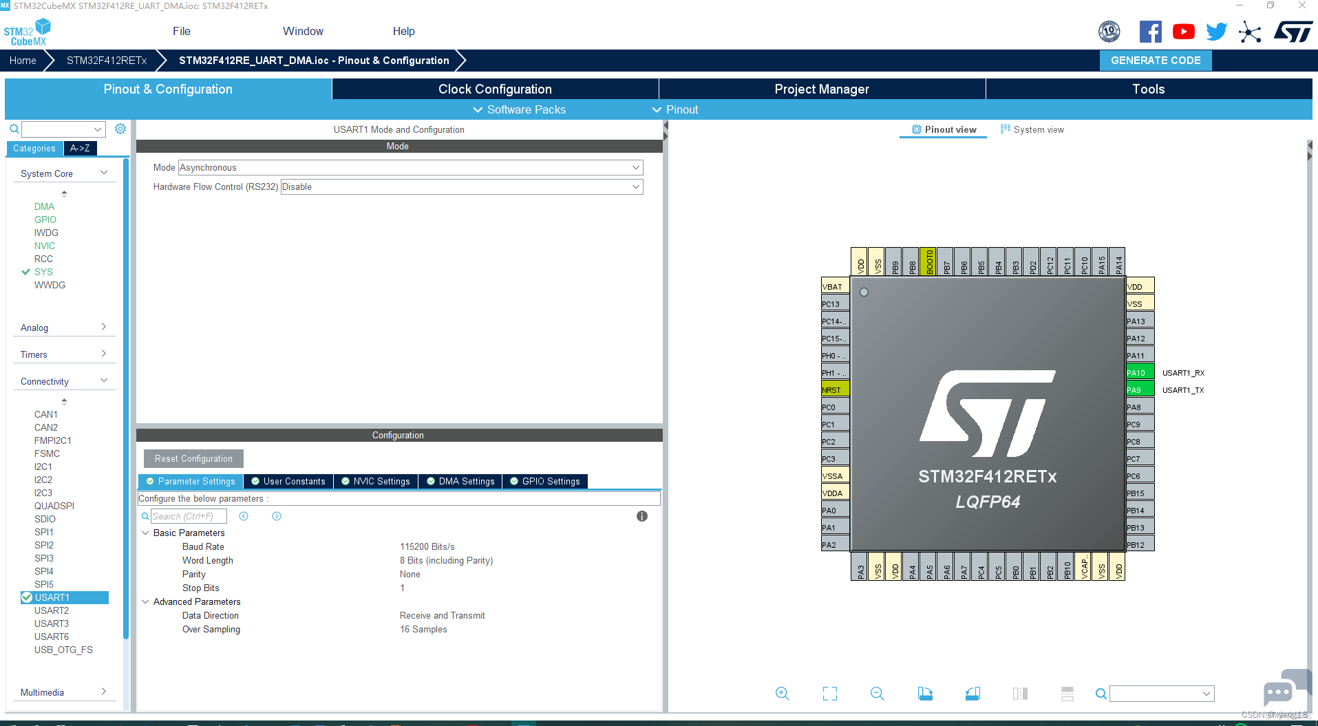

1.  CubeMX配置——UART
) \& d: Z3 W$ }) ~1 F6 f5 ?, D7 J
' h, V) H0 o6 R& Z; R- W, u- J, Q8 N; v 191f85c39c884f878fd6691d7a6a81d2.png % P  i6 L0 e# H$ w' w

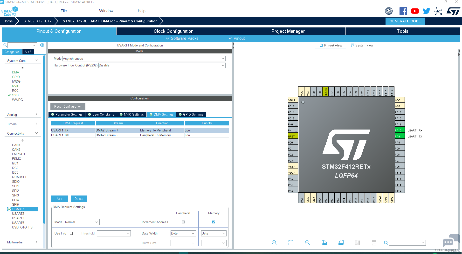

- V9 `# h, E$ [2.  CubeMX配置——DMA- c1 G8 i4 q8 L  J) k
- H5 W9 k* x8 P2 c f0021affdc994955a3ef5b7e67c4c18a.png 2 f9 k4 f, i( `) D( X$ ?
5 t, u2 K# w4 t

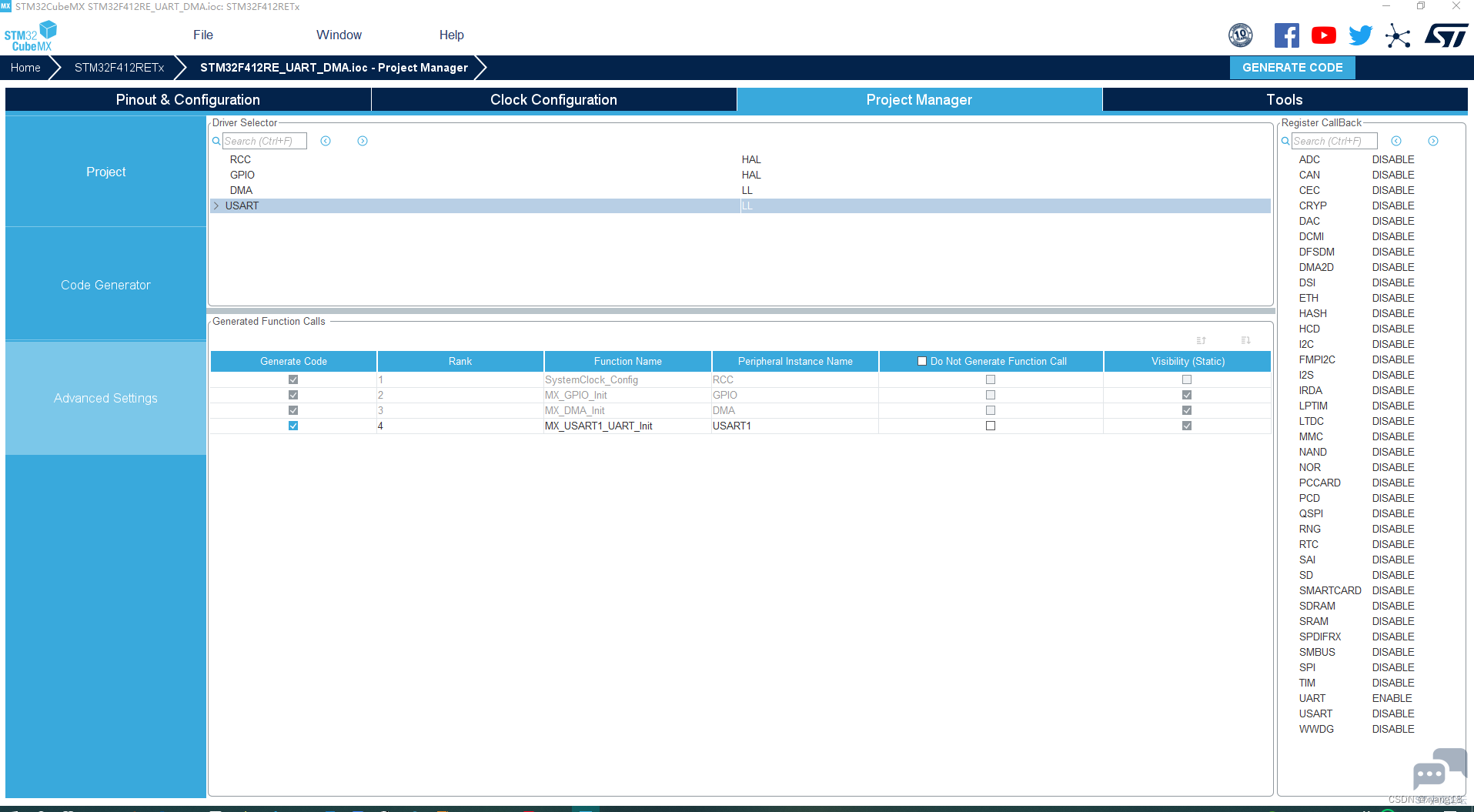

3.  CubeMX配置——设置LL库
3 v' ?0 y! ^6 c7 |/ d
& j0 M/ g3 V( d  a! [8 j% l' V0 C3 @ 4a2190d5a34b452892f673455f4a4216.png

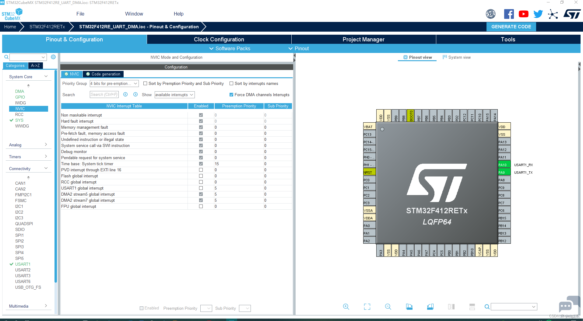

. m0 a" g# D! S+ {/ D: e4.  CubeMX配置——设置中断
. A' m3 q; L, O' d; w5 J; W# o- G. F
不启动UART中断& B' w5 y$ a% l- g: I0 E
& w- K% x% U9 c& U
fa6641a028d84432aec4b33c484631af.png * F* S5 {. U  _! r, w$ F

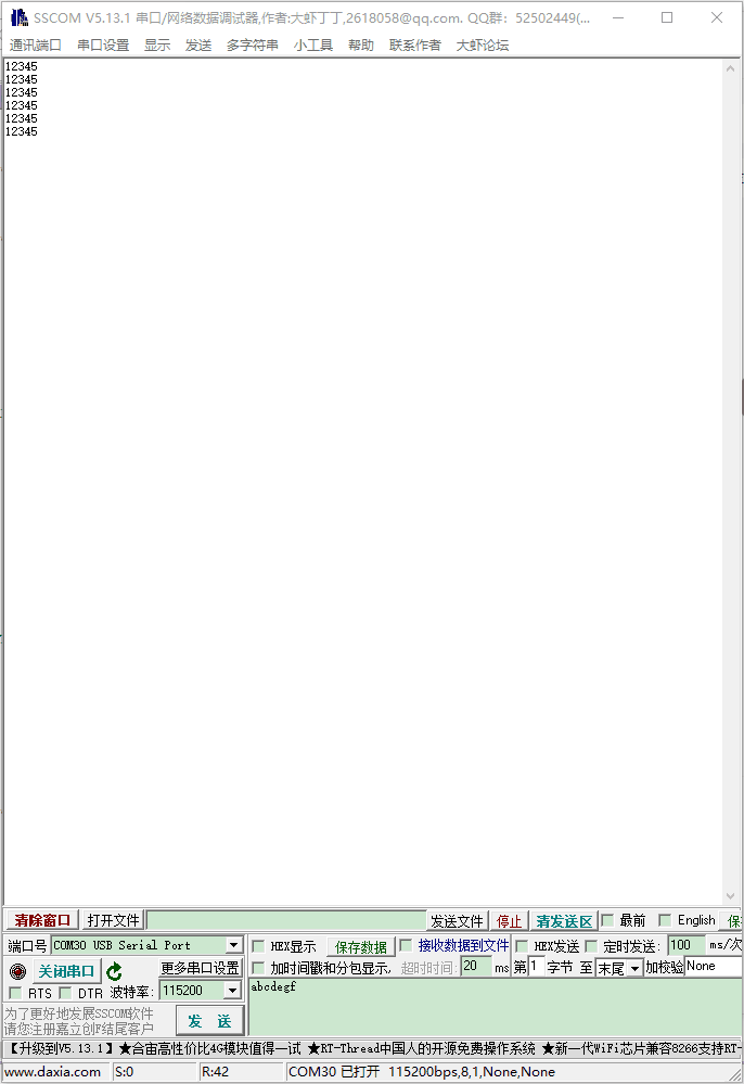

6.  串口接收到数据* e. j& C6 D4 ~5 U$ S- F
/ T" f( x5 A9 m( S+ E* T
* v- b. b" |+ j  y; J9 x
