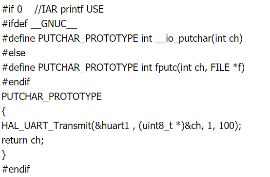

根据MDK获知IAR选择即可,把他定义在main.c的main函数前面" x7 H9 p) O. i) x/ S } #if 0 //IAR printf USE #ifdef __GNUC__ #define PUTCHAR_PROTOTYPE int __io_putchar(int ch): @3 U3 B9 X0 J% x% L# r #else #define PUTCHAR_PROTOTYPE int fputc(int ch, FILE *f)( Z4 a* r' n$ g5 m8 ] m #endif6 ?+ u7 S4 E. z8 k: q/ y( W PUTCHAR_PROTOTYPE! J! {1 x4 r: u! a; e. \ { HAL_UART_Transmit(&huart1 , (uint8_t *)&ch, 1, 100); return ch; }7 r0 Q' [: I& [& Y9 w; k #endif : [; k2 p+ k2 D' U; E / F9 ^% {. e( s; }; x1 m. ~" ?% N #if 1 //MDK printf USE #pragma import (__use_no_semihosting)' D+ [8 a: y5 w/ ?$ Z struct __FILE% ~' M6 |: h) r3 d* p" O' S {4 M6 p: ] i3 |) L4 s4 C int handle; }; FILE __stdout;. v/ q+ M6 \- Q' c void _sys_exit(int x) { x=x;+ L7 r2 B: P1 \$ J& Z3 F }& [, I4 L% ]- W5 \# y" S7 q C; F' d3 t int fputc(int ch, FILE *f)+ Z8 t) w' @$ q9 W { //while((USART1->SR&0x40)==0); //USART1->DR = (uint8_t) ch; HAL_UART_Transmit(&huart1 , (uint8_t *)&ch, 1, 100); return ch;. a( _) F! W' S4 D( Z }) b( J. g- s* C/ I #endif 0 K$ K& Y6 x- h9 T) A: P 1 Y8 E ]2 @9 x0 Q5 @, n& V 如果用错有可能出现程序不运行的情况,debug要点几次才运行的情况 ————————————————, x8 j/ z3 |# b- [7 Q5 w& ] 版权声明:鱼入大海_- `2 V! |( r+ k7 `: p0 O |
