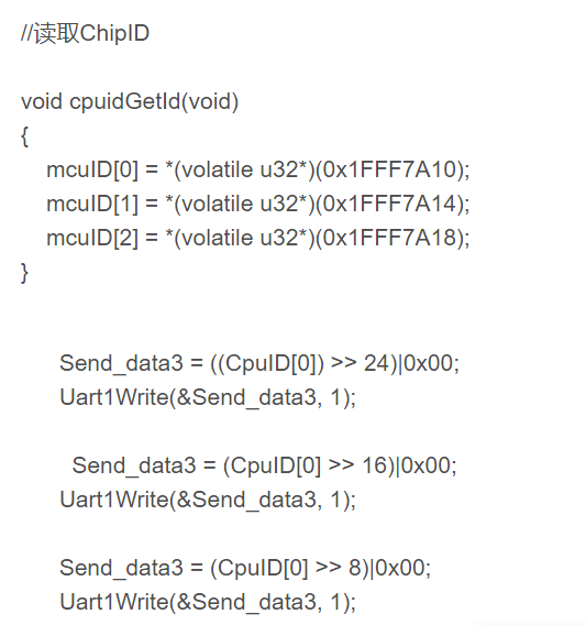

  10. //读取ChipID
    1 [+ r0 E' K" q8 v
  11. ( c6 t8 g: M' o7 i
  12. void cpuidGetId(void)
    0 }. @# N  U/ @+ S
  13. {
    - `& t" z7 U+ ?
  14.     mcuID[0] = *(volatile u32*)(0x1FFF7A10);% D5 n( R" c' }
  15.     mcuID[1] = *(volatile u32*)(0x1FFF7A14);
    6 L4 \) K& \3 ~4 G* P
  16.     mcuID[2] = *(volatile u32*)(0x1FFF7A18);
      a7 c" s# T8 i/ t& ?% N7 J
  17. }
    4 A+ u1 C3 `9 [0 v  K5 V: w, G  E
  18. 4 o& n% z' j- Y* o0 E% B2 {
  19. ' ]  g- n% O. ^' j# R  [3 d
  20.       Send_data3 = ((CpuID[0]) >> 24)|0x00;, L7 d" t( B. H" r9 w3 o
  21.       Uart1Write(&Send_data3, 1);- P9 U2 S1 T% k' a9 P& i0 P& R- d5 P
  22.
    1 |$ E* `/ \- E) \* y" t
  23.         Send_data3 = (CpuID[0] >> 16)|0x00;
    # F* ]- K6 x# b, d4 K% Y, T- n
  24.       Uart1Write(&Send_data3, 1);
    " u& k4 p2 h- M9 @/ P
  25.                       n+ H4 t7 |; A8 ^4 `0 d. u, k- B
  26.       Send_data3 = (CpuID[0] >> 8)|0x00;0 \& H5 D3 K* E( k8 W
  27.       Uart1Write(&Send_data3, 1);" U3 v0 c5 S0 Q; a; v% J
  28.         & w7 K8 \, `; f3 U! c, P6 k
  29.       Send_data3 = (CpuID[0] )|0x00;8 ?& ]4 R4 h( F+ [8 C5 \  ^
  30.       Uart1Write(&Send_data3, 1);
    2 s& c" T0 m# r  G! z! k
  31.     ! I7 }% C7 \- O! X3 [' _: h
  32.       Send_data3 = ((CpuID[1]) >> 24)|0x00;& g1 A, H' Y$ O1 l; ^- n
  33.       Uart1Write(&Send_data3, 1);+ A/ A2 l' F1 O1 V& I
  34.
    . n" s8 o& w- z4 j0 \+ A' r
  35.         Send_data3 = (CpuID[1] >> 16)|0x00;
    . Q; d4 U9 b; v, u
  36.       Uart1Write(&Send_data3, 1);5 }0 S8 L& X# a; M+ s. `
  37.
    # A. B( |' J8 H0 A2 S
  38.       Send_data3 = (CpuID[1] >> 8)|0x00;" @5 p" W* L9 b% Q- K
  39.       Uart1Write(&Send_data3, 1);
    6 n) S, k* g9 o5 y: ~9 x8 C
  40.         1 c* R+ m; j4 D' i
  41.       Send_data3 = (CpuID[1] )|0x00;/ C5 m* Y. {/ H8 L) z# D8 O
  42.       Uart1Write(&Send_data3, 1);
    2 p4 z! {* \6 L! m
  43.         : h2 }# u1 p% A* K' Y& s. A' A
  44.         Send_data3 = ((CpuID[2]) >> 24)|0x00;
    0 j0 |. F6 f/ j, R: e
  45.       Uart1Write(&Send_data3, 1);) k* M3 L3 s+ l3 w0 Z0 F
  46.
    ( B% F% n) U4 y  G
  47.         Send_data3 = (CpuID[2] >> 16)|0x00;
      ~. }, f$ G8 c+ \" X% R
  48.       Uart1Write(&Send_data3, 1);
    ( E, b" G. C. l6 N. z$ L
  49.                     ; }. P( Y6 x. u! z
  50.       Send_data3 = (CpuID[2] >> 8)|0x00;
    0 U( @3 @: @% p4 X: d
  51.       Uart1Write(&Send_data3, 1);
    2 a; o) [# b, C9 \. o. f4 D
  52.
    7 W- T: Y" H$ N& r3 }+ G6 D- O# m
  53.       Send_data3 = (CpuID[2] )|0x00;
    ( w- h2 W* G) n2 n4 T1 ]. ]  d
  54.       Uart1Write(&Send_data3, 1);
! H1 q3 @# N* m. T8 r7 k. r4 w! Y7 O7 T
