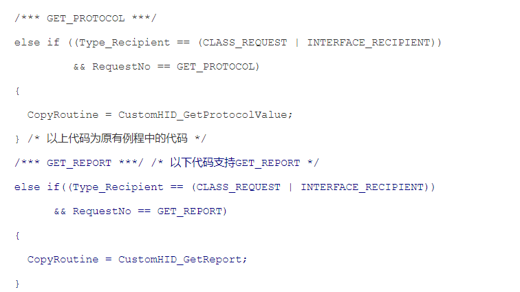

1)在usb_prop.c的函数CustomHID_Data_Setup()中,GET_PROTOCOL之后增加如下代码:
  1.   /*** GET_PROTOCOL ***/
    9 i. h+ F% r7 l
  2.   else if ((Type_Recipient == (CLASS_REQUEST | INTERFACE_RECIPIENT))
    . c6 i0 `2 K! K# X3 B3 E% i* j+ K
  3.            && RequestNo == GET_PROTOCOL)' j4 L% E8 P( e1 q
  4.   {
    ( D& i# u0 A$ l
  5.     CopyRoutine = CustomHID_GetProtocolValue;
    , V; R* w# p8 u" ^, w
  6.   } /* 以上代码为原有例程中的代码 */8 L, G) c( j' k" p6 V2 A. ~
  7.   /*** GET_REPORT ***/ /* 以下代码支持GET_REPORT */
    ! X9 N! @/ m  R, o
  8.   else if((Type_Recipient == (CLASS_REQUEST | INTERFACE_RECIPIENT))
      ~; X9 v0 R* u6 V- ?
  9.         && RequestNo == GET_REPORT)4 `) \3 V9 b7 q( J; v/ ], F1 a- j
  10.   {% B$ k- ~; r8 |; k* T5 b5 \
  11.     CopyRoutine = CustomHID_GetReport;  j) m4 I* H3 k* k
  12.   }
