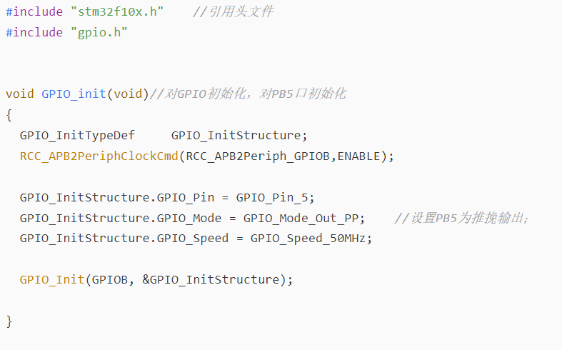

二、编辑gpio.c文件;1 x  a' L* z2 t8 Q
  1. #include "stm32f10x.h"    //引用头文件3 M. p, @/ q: G
  2. #include "gpio.h"8 b" i1 g$ W% M* S. [
  3. - g" Q! Q9 N' B2 _( J
  4. % m. O0 Y. t& D& ]' d
  5. void GPIO_init(void)//对GPIO初始化,对PB5口初始化
    2 N( j2 p5 V& I; _7 D- I* H/ J4 K
  6. {
      J0 u  j( u; b* R1 k
  7.   GPIO_InitTypeDef     GPIO_InitStructure;. w; o4 u( E: O
  8.   RCC_APB2PeriphClockCmd(RCC_APB2Periph_GPIOB,ENABLE);
    2 G8 O/ i+ q1 M3 @: }9 B( r! W
  9.
    0 O0 `! g$ F! B/ A% @; _' `
  10.   GPIO_InitStructure.GPIO_Pin = GPIO_Pin_5;
    4 L0 S& |2 H2 r4 q+ B& @, B% I7 o
  11.   GPIO_InitStructure.GPIO_Mode = GPIO_Mode_Out_PP;    //设置PB5为推挽输出;$ a+ v* ]) m1 ^- N/ L4 n6 h# g3 y
  12.   GPIO_InitStructure.GPIO_Speed = GPIO_Speed_50MHz;
    2 m# f4 x: @, h& j# S
  13.
    * P6 D. b- q4 _, h
  14.   GPIO_Init(GPIOB, &GPIO_InitStructure);
    , z* z" l- ?6 t7 B* A
  15.
    ! G& _* {9 O& M7 l3 T
  16. }
