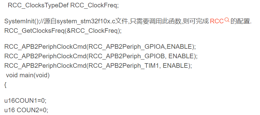

因为用stm32f103c8 因此想到外部时钟触发模式 3 n: k9 d6 E5 y1 f( e, R
  RCC_ClocksTypeDef RCC_ClockFreq;6 r6 u0 l" u) t! d
( U7 q  J2 w8 t9 V+ g1 i
SystemInit();//源自system_stm32f10x.c文件,只需要调用此函数,则可完成RCC的配置.
, \3 g. R& A. N0 ^( G2 ]RCC_GetClocksFreq(&RCC_ClockFreq);
" ?9 o, ~8 X" i! r: _0 Q* k9 b7 q9 T1 _5 b5 s2 n
RCC_APB2PeriphClockCmd(RCC_APB2Periph_GPIOA,ENABLE);7 J: y2 W: W0 r) N9 L" R0 F1 ~
RCC_APB2PeriphClockCmd(RCC_APB2Periph_GPIOB, ENABLE);
4 i1 W$ o; ?) L( G: iRCC_APB2PeriphClockCmd(RCC_APB2Periph_TIM1, ENABLE);
% y. o0 V. e& b0 W% R0 h void main(void)
3 j% S9 ?7 e- S{
# ?9 C3 j6 M& G( g: ~; Mu16COUN1=0;
$ V) N, {' ~. z+ u. S5 \9 s( Eu16 COUN2=0;
6 S/ w+ F6 _1 i/ V4 L9 ?; l
- K/ I1 p: s6 a. pwhile(1)1 [, P3 \! D' ]* q/ F  }3 w6 B
{undefined1 D7 ?3 h$ w: e  c" w( M
   COUN1=TIM1->CNT;
8 I8 |( \& j  F}
" u8 C- y# s8 v0 O9 |* B7 P% g}
) g4 E3 a6 R: h) w8 B4 P
+ h2 z+ g0 X" w1 U8 Y* V* uGPIO_InitTypeDefGPIO_InitStructure;
' o1 M) Q3 v  G6 ]/*PA0,PA12-> 左右脉冲输入 */
5 w  ~* E, @: `: T+ JGPIO_InitStructure.GPIO_Pin = GPIO_Pin_0;
/ _8 m7 N# E# X7 x% w  x1 [8 ?GPIO_InitStructure.GPIO_Mode = GPIO_Mode_IN_FLOATING; //) D* R! u6 J+ K, g
GPIO_InitStructure.GPIO_Speed = GPIO_Speed_50MHz; //50M时钟速度0 I7 V0 J) I7 [
GPIO_Init(GPIOA, &GPIO_InitStructure);
5 d$ R+ A. Z- N' T# l, g: D0 m6 g: ]# G  e" A$ E
voidTIM1_Configuration(void) //只用一个外部脉冲端口4 j! E2 a: T0 ^, O
% r8 E. K5 T4 V9 }# [) z) [- u  R; c0 A
TIM_TimeBaseInitTypeDef   TIM_TimeBaseStructure;- f5 j1 P" r9 `# s! e: p; F
   //配置TIMER1作为计数器
3 r( |# ]' @$ X   TIM_DeInit(TIM1);/ r- h. O' j, S
  TIM_TimeBaseStructure.TIM_Period = 0xFFFF;! a  c; D, [/ {* D% j
TIM_TimeBaseStructure.TIM_Prescaler = 0x00;
8 V3 [5 A7 I. h- m' p4 DTIM_TimeBaseStructure.TIM_ClockDivision = 0x0;9 ^0 k, P& I5 Y7 t$ o$ a
TIM_TimeBaseStructure.TIM_CounterMode = TIM_CounterMode_Up;
$ e- v( u) A; z- @: pTIM_TimeBaseInit(TIM1, &TIM_TimeBaseStructure); // Time base configuration
" v- ^, `1 Z6 K  h* q+ g9 I0 JTIM_ETRClockMode2Config(TIM1, TIM_ExtTRGPSC_OFF,TIM_ExtTRGPolarity_NonInverted, 0);1 r9 y4 p* C3 _: P& u
TIM_SetCounter(TIM1,0);" ^, u4 O, C+ Y" f" ]* G
TIM_Cmd(TIM1, ENABLE);' C& F: j) m  M/ e& V
4 }. ]0 L6 }6 h: q8 C+ J' i+ j2 p9 E- L
* f7 }; F# j8 i! l( w& K1 n
程序解释:
6 \2 q& {0 P; b1 l8 w注意:
! J4 M. a6 k% k- j第一步:(1)stm32f103c8只有TIM1_ETR(PA12,Pin33)
9 i( E' _" i- I              (2)外部时钟输入与中断无关
% V3 L1 e  @4 b0 @' }/ T/ s+ v. w第二步:设置RCC第三步,设置定时器模式) _- ~7 x& }  s0 G* ?  P
第三步,设置定时器模式4 Q) T1 d, \) e3 N" e* @
第四步,可以在主函数中读取计数器的值,其它的应用,就看具体的情况了。+ V3 o2 d$ A0 `
