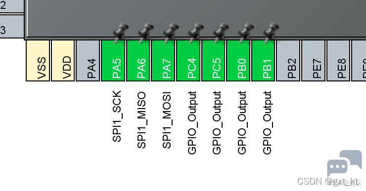

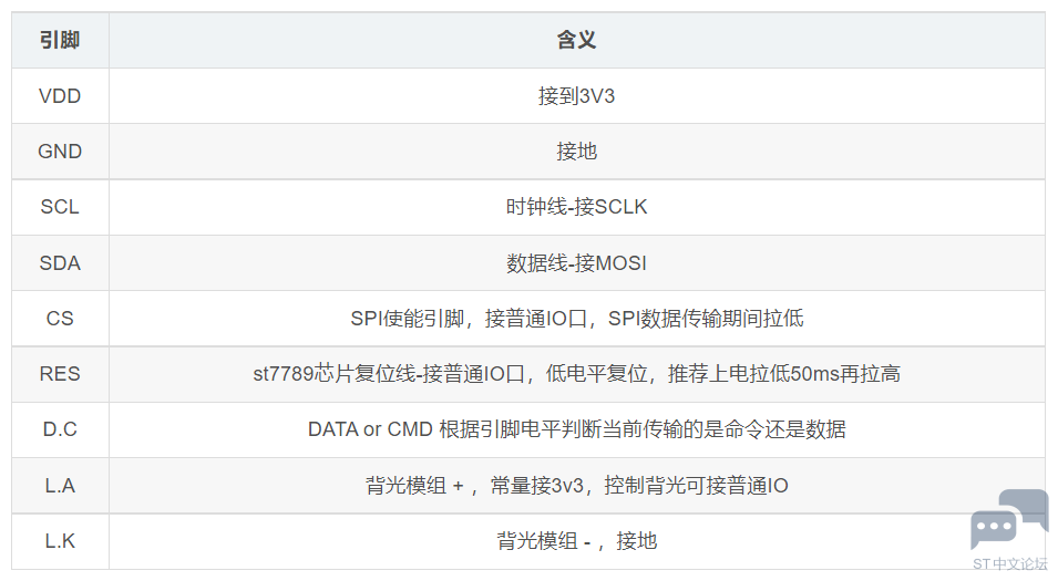

3 D l1 a5 _& K- N# r屏幕引脚定义:. D3 C, k, R4 [$ K: M5 [
, ^2 E$ ?+ ~1 _+ u

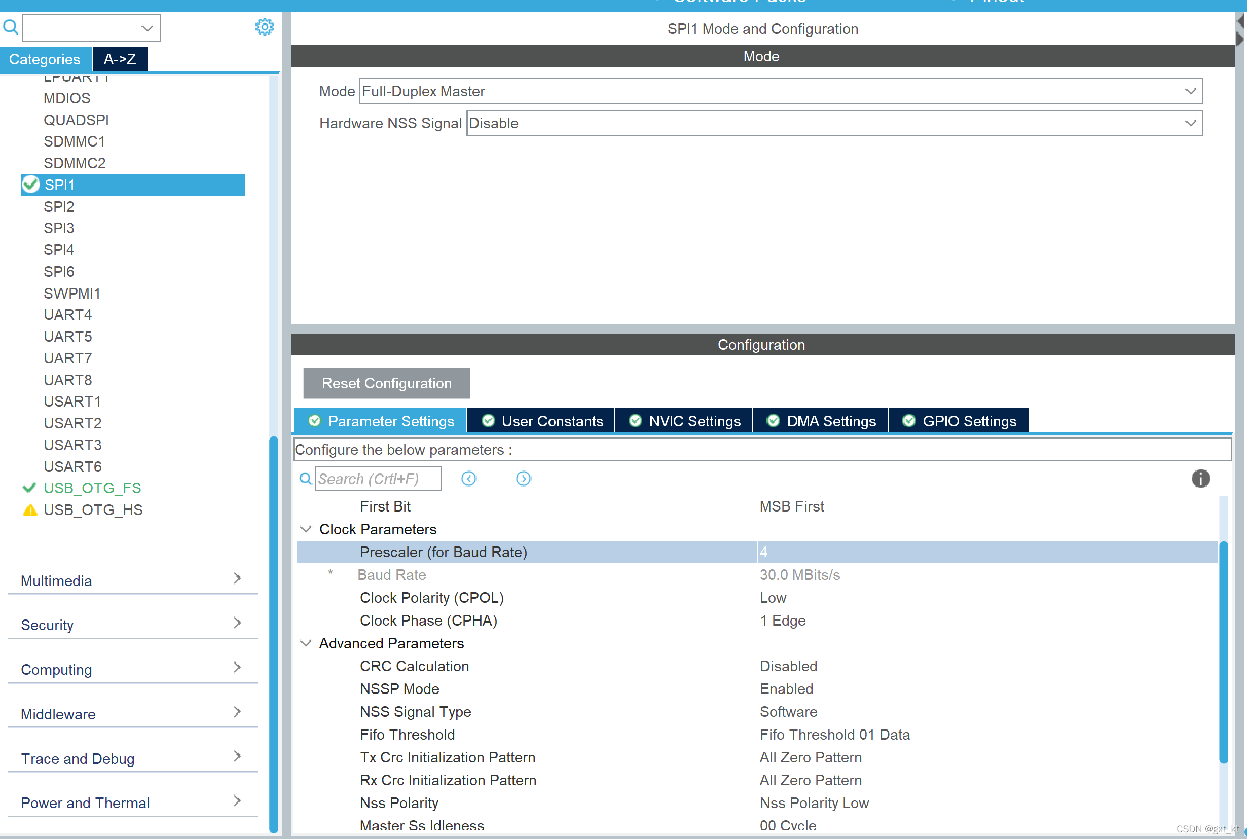

3 T, y$ y6 j$ V9 R% N2.cubemx配置: t% C: D0 @4 q4 C. a

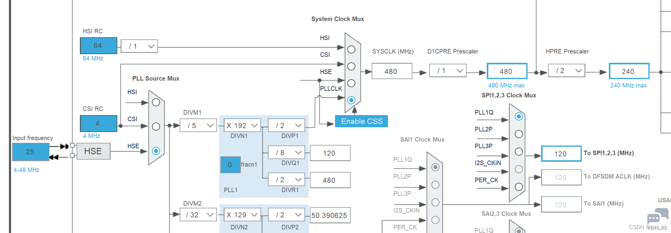

stm32H7时钟配置
( Y: j. ]: J/ y: W( T/ X0 C
8 v' m/ d) y' e: \; q
* s* P4 C; c; E5 b" I/ i

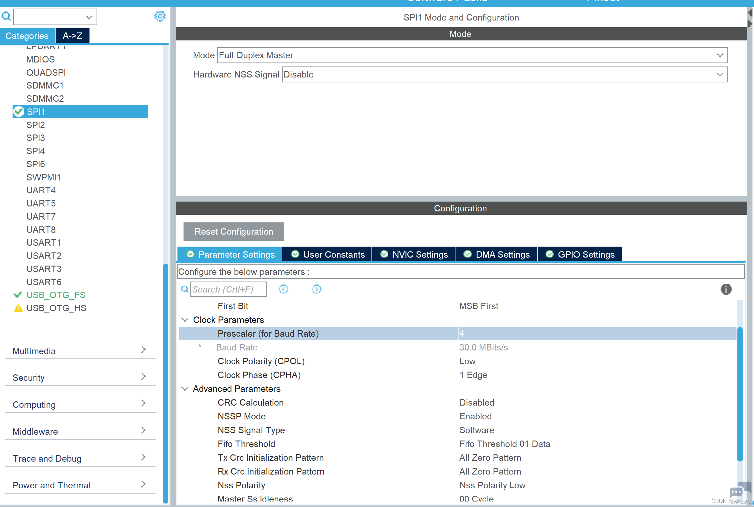

) ^# |; c: M7 W2 U实测30MBITS能够正常显示,60MBITS就不行了$ n8 V- k8 O2 N2 v: N* Q E5 t9 y
& _, K6 J5 D) m, [) j
! D& T. i; V& M/ R6 Q) o) r8 e7 B; z+ j( L: n+ V
定义相关IO输出:9 V, V3 J: v1 {& g E2 V3 p2 `: s* z
' Y% G& [0 T/ }. i( o
% `+ L2 ^# M2 z- s9 b" v* C/ W. [/ f- |' a

* A; g, M+ b" z2 c - //==========================================
9 W7 R3 G* k; c- \: F$ }3 ~1 `, G - #define LCD_RES_GPIO GPIOC- T* n7 W. u& N0 p9 Q; M4 S- U
- #define LCD_RES_GPIO_PIN GPIO_PIN_4
, i: e4 C7 s$ p: d/ _ - #define LCD_DC_GPIO GPIOC! P0 p+ |3 j p; d( _# X5 B
- #define LCD_DC_GPIO_PIN GPIO_PIN_5
5 j& O; \$ V+ \7 E8 c - #define LCD_CS_GPIO GPIOB+ w# G3 ?% n9 N4 S& e
- #define LCD_CS_GPIO_PIN GPIO_PIN_0
1 D5 ^( O& {' U! K9 A/ Z4 g- y - #define LCD_BLK_GPIO GPIOB
3 Y9 l" d" p' z2 k - #define LCD_BLK_GPIO_PIN GPIO_PIN_1 ~! u8 }# r2 b
