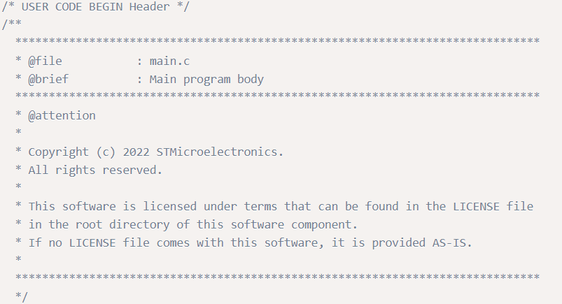

  1. /* USER CODE BEGIN Header */
    - X5 j; k* I6 q; }6 Z4 K; @4 O+ e
  2. /**
    6 _, k# f& L: v
  3.   ******************************************************************************
    * p- L( d( }9 x& K" X7 y3 F2 ~5 q$ ]2 z
  4.   * @file           : main.c
    3 l& p+ v- F; p7 f& T  W+ W
  5.   * @brief          : Main program body1 g( p' P0 H; {1 n7 i
  6.   ******************************************************************************
    9 J  T2 l5 y" ~1 Y4 J( j
  7.   * @attention
    2 m& T$ X' e+ {) \1 G3 R- M; ]
  8.   *
    2 v9 _4 ~6 `. d
  9.   * Copyright (c) 2022 STMicroelectronics.
    9 `0 d% p$ z3 [6 I) t$ c' A+ H
  10.   * All rights reserved.
    $ @* Y' \( c- w) u
  11.   *
    6 O" T) S2 X$ Y9 M
  12.   * This software is licensed under terms that can be found in the LICENSE file
    " P; U1 N- ^( A+ w0 M4 o
  13.   * in the root directory of this software component.
    # ?' z, f: @/ N% i$ n7 W4 \) W
  14.   * If no LICENSE file comes with this software, it is provided AS-IS.) X! G$ |* J. x/ a0 |  [  Z8 m; F$ w
  15.   *7 f' M; ]* i$ H3 M' A5 G
  16.   ******************************************************************************
    ) e- g% P4 g: H2 ~4 V$ g) y
  17.   */* @2 V) y6 A8 L5 }' B
  18. /* USER CODE END Header */' h5 |' {- E4 D
