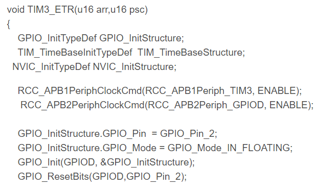

本文适用于STM32F103最小系统板,其他的STM32系列也大同小异。话不多说,直接上代码/ O. c0 i& U* P. K& U 先写time.h文件7 d( l* T4 l: w2 c( e$ f #ifndef __TIMER_H #define __TIMER_H8 K) ~% c: |- o0 ?+ p4 }, @1 R #include "sys.h"% j. ^; d" O, |$ y2 w5 o, I) k % P2 ]! O2 P' @: Q% H4 C( ?. j void TIM3_ETR(u16 arr,u16 psc); #endif. k2 b4 K; w' M# O% q $ g0 l* u Y/ C: x, q5 y 我是用TIM3的ETR功能的引脚PD2,其他也是一样的。7 `8 |% s! q' a; N( @( q 再写timer.c8 |1 k$ b X8 r6 H" R #include "timer.h"' j( }: _$ k% H5 i# y: ^ #include "led.h"4 m4 z( E% \' A #include "usart.h"$ x7 u. h/ b7 S- b6 s g" j* n ' }6 i4 X& N3 v% t - z7 U$ r+ d& x% R //定时器3外部输入脉冲计数ETR配置 2 f# a/ f- z" o4 b" p8 L( q8 j ( W" j# l# F, {# S- o$ F void TIM3_ETR(u16 arr,u16 psc), R! s+ K; C9 |5 g { ( q. v1 ^ u [! Z- _7 `) @* U GPIO_InitTypeDef GPIO_InitStructure; TIM_TimeBaseInitTypeDef TIM_TimeBaseStructure; NVIC_InitTypeDef NVIC_InitStructure; q" D0 `0 t4 I& Y+ V. y/ k 9 {, j2 j6 a5 d- f+ @ RCC_APB1PeriphClockCmd(RCC_APB1Periph_TIM3, ENABLE); RCC_APB2PeriphClockCmd(RCC_APB2Periph_GPIOD, ENABLE); + h1 X- {; O- d1 k# h: j GPIO_InitStructure.GPIO_Pin = GPIO_Pin_2; " ^) h! s) T) a- [4 m GPIO_InitStructure.GPIO_Mode = GPIO_Mode_IN_FLOATING; : `( r: `3 z r; Z GPIO_Init(GPIOD, &GPIO_InitStructure); GPIO_ResetBits(GPIOD,GPIO_Pin_2); * Q! h) z7 [( F# ^/ a& z //初始化定时器 TIM3 TIM_TimeBaseStructure.TIM_Period = arr; //设定计数器自动重装值 % K q s: Z* c3 E5 Y: @ TIM_TimeBaseStructure.TIM_Prescaler =psc; //预分频器 5 ]1 `" F; A4 L. X! o) @ TIM_TimeBaseStructure.TIM_ClockDivision = 0x0;: Q7 g- U; q3 f TIM_TimeBaseStructure.TIM_CounterMode = TIM_CounterMode_Up; //TIM向上计数模式" @+ F$ b4 |$ |1 ~$ @/ f7 ? TIM_TimeBaseInit(TIM3, &TIM_TimeBaseStructure); //根据TIM_TimeBaseInitStruct中指定的参数初始化TIMx的时间基数单位3 v1 L x1 k& ? 6 Z- b3 U6 k! R ' F" X, e0 \: Z, e //中断分组初始化4 u* q8 o# h; H0 v) q/ j2 v' V NVIC_InitStructure.NVIC_IRQChannel = TIM3_IRQn; //TIM3中断- p- |' l6 `- E* Q7 F* f NVIC_InitStructure.NVIC_IRQChannelPreemptionPriority = 2; //先占优先级2级 NVIC_InitStructure.NVIC_IRQChannelSubPriority = 0; //从优先级0级4 O. d8 s# Q) i+ d2 p NVIC_InitStructure.NVIC_IRQChannelCmd = ENABLE; //IRQ通道被使能 NVIC_Init(&NVIC_InitStructure); //根据NVIC_InitStruct中指定的参数初始化外设NVIC寄存器 % o5 u! x) H# G TIM_ITRxExternalClockConfig(TIM3,TIM_TS_ETRF); TIM_ETRClockMode2Config(TIM3,TIM_ExtTRGPSC_OFF, TIM_ExtTRGPolarity_Inverted,0x00); TIM_SetCounter(TIM3, 0); TIM_ITConfig(TIM3,TIM_IT_Update,ENABLE);//允许更新中断 ( o2 j4 l. f! _* n% y+ J. `0 G3 _, Z TIM_Cmd(TIM3,ENABLE ); } # {: l$ J) ~* s, \1 ]' \ 0 U- Y0 o3 _' F: f: v ' B" j3 z9 W( N- |. f ; z- o) O% t+ H+ A+ E, j, ^ //定时器3中断服务程序 void TIM3_IRQHandler(void) { if (TIM_GetITStatus(TIM3, TIM_IT_Update) != RESET) //获取中断状态# e9 E# {0 m7 D { TIM_ClearITPendingBit(TIM3, TIM_IT_Update);' ?( _) v# E5 B6 _+ L, N- R+ z5 ] LED0=!LED0; } }9 v" G! ?4 I' o1 g# C9 g 最后写main.c" e) H4 h' A2 f, J" z8 v #include "led.h" #include "delay.h" #include "key.h" #include "sys.h" #include "usart.h"& R' A0 z9 @7 \3 j n. S #include "timer.h" ; a2 t8 O8 e# R + J7 v _8 G0 m- U) k) p B int main(void) {+ }' E1 m9 w' F+ D NVIC_PriorityGroupConfig(NVIC_PriorityGroup_2);//设置系统中断优先级分组20 i2 K( `' c9 z' X. _/ T3 t7 H delay_init(); //初始化延时函数 uart_init(115200); //初始化串口波特率为115200% N; @$ z+ `, O/ l9 K) p: k3 a: S, a7 _ KEY_Init(); //初始化与按键连接的硬件接口 LED_Init(); //初始化LED端口 TIM3_ETR(1000,0); # u' t. e. d0 t# B while(1) {printf("Count=%d\n",TIM_GetCounter(TIM3));; M+ X; v, K; u4 ~ LED1=!LED1;}2 x) }) G: E7 l } 3 O9 [7 e1 _) e) r2 ^0 [ ; J8 G: D% ]7 c- k% u( l- m/ E$ K 观察到的现象是:当给PD2输入脉冲时,在串口上打印出脉冲数目,每满1000次,LED0闪烁。可更改中断服务函数实现所需功能。% u# F3 d N+ U& D ———————————————— 版权声明:李隆晨 |
