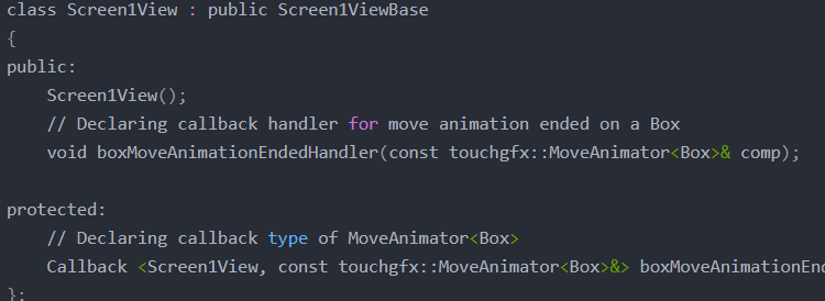

5 c0 t/ ?# R) |0 e5 F; ~4 T同时也可以设置一个动画结束时的回调函数,如下所示:6 V1 q1 c* N+ m6 y' t2 T
  1. class Screen1View : public Screen1ViewBase" c5 ^3 q4 a+ d: n. A. @
  2. {3 F# l5 d* N3 B* W4 @; u
  3. public:  Y2 J/ E& D2 w$ z- g1 q
  4.     Screen1View();- C3 x# J) g& e) O8 M
  5.     // Declaring callback handler for move animation ended on a Box0 ~& k- W- i9 f5 _, r
  6.     void boxMoveAnimationEndedHandler(const touchgfx::MoveAnimator<Box>& comp);: b# a3 B( D) H) n
  7. 3 z+ K, w# Z4 Q
  8. protected:
    2 o  B0 l9 X; y
  9.     // Declaring callback type of MoveAnimator<Box>3 P: E& J6 ]: ^! `9 k  Q. v
  10.     Callback <Screen1View, const touchgfx::MoveAnimator<Box>&> boxMoveAnimationEndedCallback;
    ) y7 s: v0 X" L9 @
  11. };
    % ?" K1 `2 t* k
  1. Screen1View::Screen1View() :3 w/ E, U' N2 n& _+ U
  2.   // In constructor for callback, bind to this view object and bind which function to handle the event.
    $ }& B; Z$ a  [' G. Y+ B
  3.   boxMoveAnimationEndedCallback(this, &Screen1View::boxMoveAnimationEndedHandler) { }% S1 E. L  L, d& v! E
  1. void Screen1View::setupScreen()
    ) D! }; ]; [$ d# ]+ `' l2 M  N
  2. {
    % S9 j" V  r( H5 _7 {7 {. N
  3.   // Add the callback to box0 Z% h/ M; Q, F9 z; |5 [) I! [
  4.   box.setMoveAnimationEndedAction(boxMoveAnimationEndedCallback);' O* |9 o/ A3 _$ o" u+ ~
  5. }
