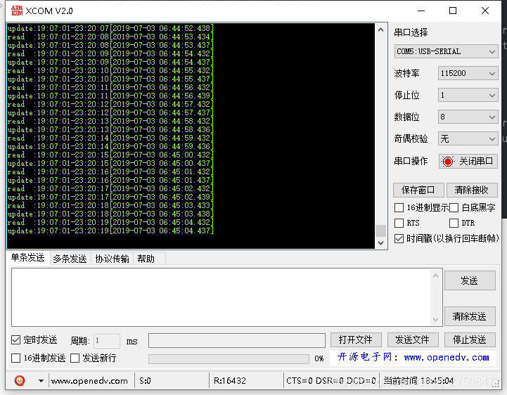

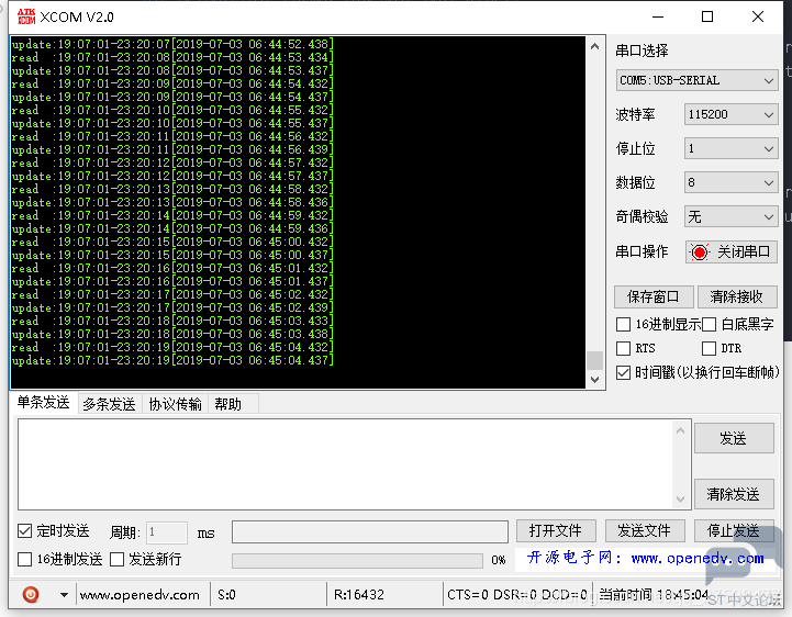

5 n+ O* }* D8 N$ B简单的测试程序,其中rtc_update_flag在RTC中断中赋值的,用于更新后打印。* W" h3 i; |8 Z4 ?6 w
  1. while(1); i8 U6 x. J( m) @, W" p2 ?# n; N
  2.     {$ z- d9 X2 |$ |* m
  3.         if(rtc_update_flag==1)- }. v' X( o2 s
  4.         {5 N, \3 k/ w! Q& K& J" z! r/ @- ?
  5.             rtc_update_flag=0;
    % b7 D" L8 K; y$ Z
  6.             RTC_GetTime(RTC_Format_BIN,&RTC_TimeStruct);1 n& _# k7 g' t" t" w4 W
  7.             RTC_GetDate(RTC_Format_BIN,&RTC_DateStruct);% m: x/ t' W9 x3 q1 C3 ~5 D
  8. ( ]" k! }$ U# g+ V: @
  9.             sprintf((char*)tbuf,"read  :%02d:%02d:%02d-%02d:%02d:%02d\r\n",RTC_DateStruct.RTC_Year,RTC_DateStruct.RTC_Month,RTC_DateStruct.RTC_Date,  _4 }; e: H  a+ I* V
  10.                     RTC_TimeStruct.RTC_Hours,RTC_TimeStruct.RTC_Minutes,RTC_TimeStruct.RTC_Seconds);
    / J: S7 ]0 V( ^# d* ^5 O$ P* J! B
  11.             printf("%s",tbuf);
    $ I* p$ D1 ]% m  G
  12.             rtc_cnt=RTC_DataToCnt(RTC_TimeStruct,RTC_DateStruct);, E2 b, n% n2 g5 ?) ?6 i0 W& `
  13.             RTC_CntToData(rtc_cnt,&RTC_TimeStruct1,&RTC_DateStruct1);# D5 M3 @. |1 @* H6 N
  14. 1 O2 V0 C7 w9 y: e9 Z
  15.             sprintf((char*)tbuf,"update:%02d:%02d:%02d-%02d:%02d:%02d\r\n",RTC_DateStruct1.RTC_Year,RTC_DateStruct1.RTC_Month,RTC_DateStruct1.RTC_Date,  }( D9 {" f3 C; V0 P4 I
  16.                     RTC_TimeStruct1.RTC_Hours,RTC_TimeStruct1.RTC_Minutes,RTC_TimeStruct1.RTC_Seconds);$ ]9 Y! ^) `& m! ?9 K
  17.             printf("%s",tbuf);$ s& C1 P6 w$ L2 Y5 G5 Q
  18. 1 G+ w/ }5 n9 l9 R% t
  19.         }
    6 i. [/ S2 K  T3 F3 m
  20.     }
    # @/ d$ l2 P. _5 y; y/ x- ]
; o4 x" c! k" J+ `9 U. X# ~
打印结果如下:
, i4 ^! H1 K  t+ C/ {1 {+ V! H
* ^3 S% a9 s- l, a0 ]0 L; T. X: G
' X3 c- \5 H( Q# ?, k8 P
