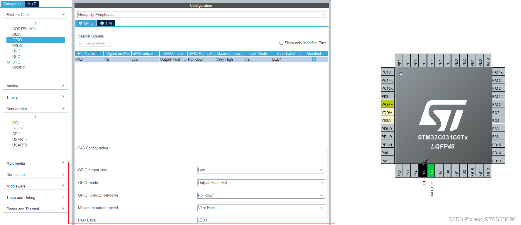

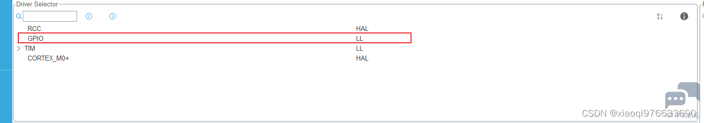

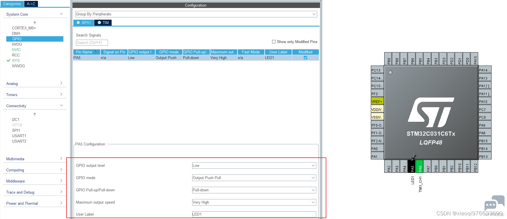

" m% A) U  |* I# `& A一、CUBEMX配置0 q, |- ?. B4 \) }. {# E, R6 q
4 S9 y# k" [) a
29bfebd66bb6479d812cdc9be3e22821.png 0 R8 D- Z8 W3 [6 ?9 b* Q
5 J& Q' ]! A! I

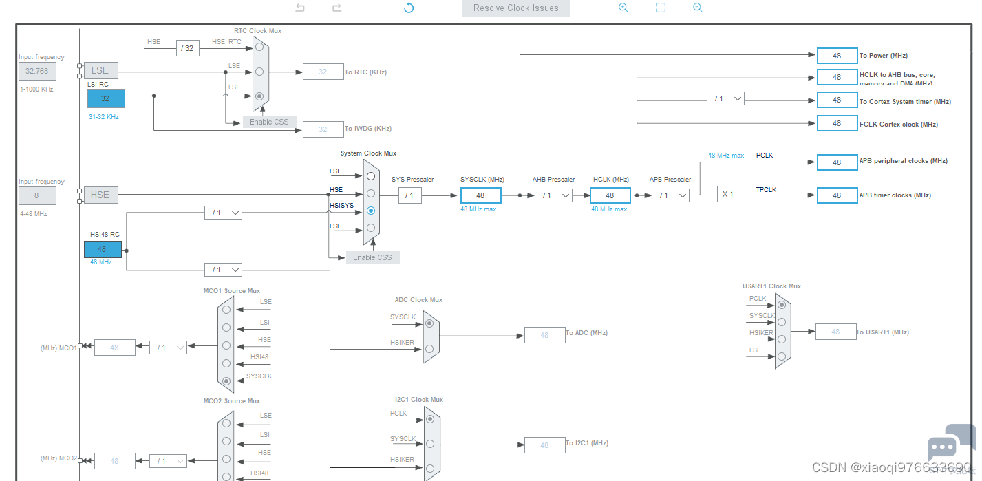

529b92c591f549a9b89074466244615c.png % b/ Y# a5 w" `7 L
8 h) n# N% n' @1 D; l- L
b893cfca9eee4275814ae81bbc04ced5.png ; a& @; T) [; F6 S
& l$ F  d& K0 [+ C5 e8 t* `; m$ e

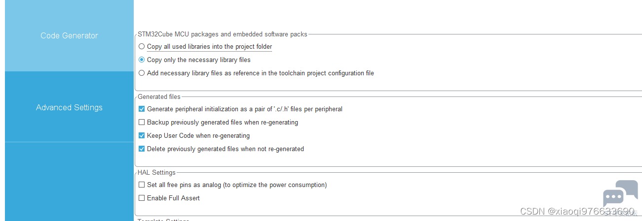

900afbff7a21498f9db2de87ece9ecb1.png / t' R: L2 q& p$ z1 s3 X+ B
1 ]7 Y  m& r3 J# }- V1 M& B& C' M

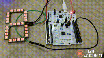

实验现象
# E6 D4 @# F8 a$ q5 Y4 y& V
# X; T, U+ C- i  A. F
. a2 D$ B' g# p7 \, r* x
