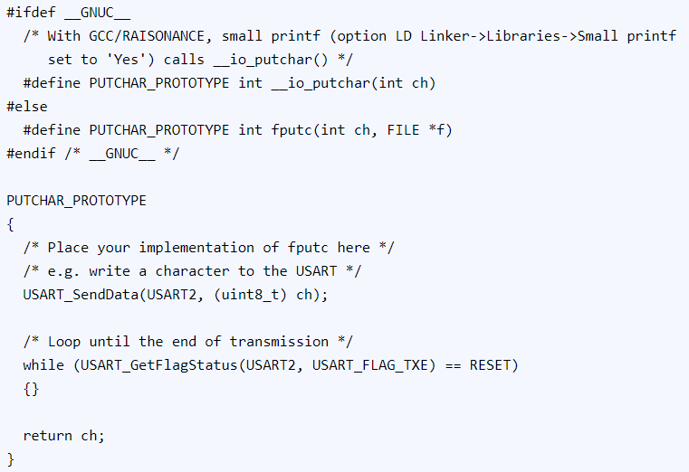

标准库重定向" y! @) M% p# n! J4 V4 J  {3 S
  1. #ifdef __GNUC__
    6 J( v' w( r  l" F$ ^1 A- w
  2.   /* With GCC/RAISONANCE, small printf (option LD Linker->Libraries->Small printf
    - G7 p) {3 g5 C& R' f1 M
  3.      set to 'Yes') calls __io_putchar() */
    ; P& B( W0 \# x7 G3 S
  4.   #define PUTCHAR_PROTOTYPE int __io_putchar(int ch); x7 A; \9 S& L, ?. C; f9 f
  5. #else
    , V, C# l8 D+ s! ]2 K
  6.   #define PUTCHAR_PROTOTYPE int fputc(int ch, FILE *f)' I$ y# M. Q/ m' w& h
  7. #endif /* __GNUC__ */
    + W" y" p# S* S+ o: O. `
  8.
    % J( c" ?* B: V0 J
  9. PUTCHAR_PROTOTYPE! G+ G5 _4 q3 @+ q' R& J' H6 Y
  10. {
    ) t! r* Q3 m+ h( x7 w  v5 P0 y
  11.   /* Place your implementation of fputc here */
    & G' C  `5 ]( y. y7 e
  12.   /* e.g. write a character to the USART */
    " ?7 `: T1 j9 ~/ @9 [
  13.   USART_SendData(USART2, (uint8_t) ch);
    % {' V( f% E$ j
  14.   E$ B9 l; L) B& |. f  B& t* v  q) b6 L
  15.   /* Loop until the end of transmission */7 m, a9 A) d  y+ N/ P& s& A/ T
  16.   while (USART_GetFlagStatus(USART2, USART_FLAG_TXE) == RESET)
    3 q+ J" ^* F' o8 q. z  m: J" Y
  17.   {}
    - h/ j5 L5 j5 k+ X( J
  18. ( H5 C* w6 T  _9 v) @2 B& [3 G: Y
  19.   return ch;1 U1 I6 m5 U( \3 Z& A' W
  20. }
