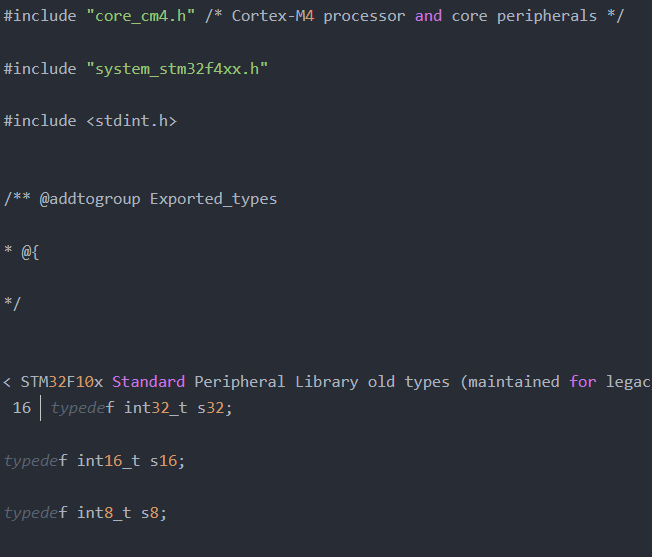

stm32使用的数据类型定义在 stm32f30x.h中
  1.   This file contains all the peripheral registers definitions, bits ! Y1 N# L4 O2 J) T
  2.   *          definitions and memory mapping for STM32F30x devices.
: i  R/ n8 c( S- W2 h% w9 }' n
整型定义:
  1. #include "core_cm4.h" /* Cortex-M4 processor and core peripherals */
    / H8 m- [' |2 R
  2. # {  A; O5 z! |( g; \
  3. #include "system_stm32f4xx.h"
    % P! t# C8 P0 V% D, G- S" J
  4. 4 _& i* D' C5 H7 D2 }; K6 I
  5. #include <stdint.h>5 J2 B9 l& \0 Q+ M6 j
  6. 0 O: x( A& A& P, d6 q2 m" e2 K5 V" G
  7. 7 h% ]  I! y* t
  8. /** @addtogroup Exported_types
      J7 \3 f  X( I1 J6 B7 }+ `
  9. ( V1 m9 f# U: j, `3 a
  10. * @{3 K2 _0 r9 N8 ?; J( `1 U1 u
  11. 0 `5 g7 h  W$ P3 M8 q$ M- }
  12. */; i. @: k6 G4 W: J! X0 q* w8 j6 I: {
  13. ) q  J% R7 O+ V. j% f, O
  14. /*!< STM32F10x Standard Peripheral Library old types (maintained for legacy purpose) */
    ; Y9 u% t+ E. a2 j2 O7 D
  15. " H+ D& v0 G; K8 `
  16. typedef int32_t s32;
