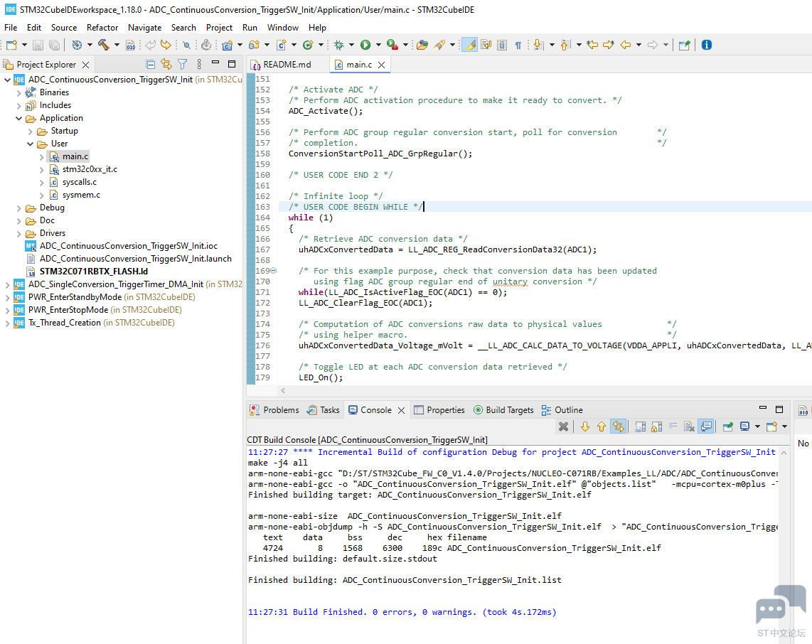

int main(void)
  LL_APB2_GRP1_EnableClock(LL_APB2_GRP1_PERIPH_SYSCFG);
  LL_APB1_GRP1_EnableClock(LL_APB1_GRP1_PERIPH_PWR);
  NVIC_SetPriority(SysTick_IRQn, 3);
  SystemClock_Config();
  MX_GPIO_Init();
  MX_ADC1_Init();
  ADC_Activate();                              */
  ConversionStartPoll_ADC_GrpRegular();
  while (1)
    uhADCxConvertedData = LL_ADC_REG_ReadConversionData32(ADC1);
    while(LL_ADC_IsActiveFlag_EOC(ADC1) == 0);
    LL_ADC_ClearFlag_EOC(ADC1);
    uhADCxConvertedData_Voltage_mVolt = __LL_ADC_CALC_DATA_TO_VOLTAGE(VDDA_APPLI, uhADCxConvertedData, LL_ADC_RESOLUTION_12B);
    LED_On();
    LL_mDelay(LED_BLINK_SLOW);
    LED_Off();

3 演示效果
编译和下载
这个正常的运行就是每次采样成功后,led闪一次。如果采样失败就保持始终是亮着。
运行显示,led断续点亮,说明运行成功。
