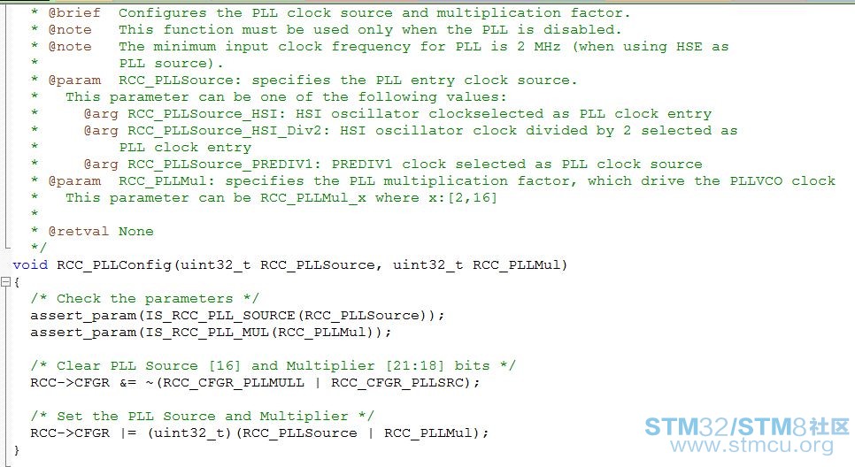

以上是STM32F3固件中的函数及说明,这是不是说明STM32F3锁相环的时钟源不能选择外部高速时钟?

手册上的时钟图上PLL是可以接外部时钟源的,但是这个函数不能配置外部 时钟源,是要 自己写吗?

使用HAL库,没有你说的那些问题。
  1. /** System Clock Configuration
  2. */
  3. void SystemClock_Config(void)
  4. {
  5.   RCC_OscInitTypeDef RCC_OscInitStruct;
  6.   RCC_ClkInitTypeDef RCC_ClkInitStruct;
  7.   RCC_PeriphCLKInitTypeDef PeriphClkInit;
  8.   RCC_OscInitStruct.OscillatorType = RCC_OSCILLATORTYPE_HSE;
  9.   RCC_OscInitStruct.HSEState = RCC_HSE_ON;
  10.   RCC_OscInitStruct.PLL.PLLState = RCC_PLL_ON;
  11.   RCC_OscInitStruct.PLL.PLLSource = RCC_PLLSOURCE_HSE;
  12.   RCC_OscInitStruct.PLL.PLLMUL = RCC_PLL_MUL9;
  13.   RCC_OscInitStruct.PLL.PREDIV = RCC_PREDIV_DIV1;
  14.   HAL_RCC_OscConfig(&RCC_OscInitStruct);
  15.   RCC_ClkInitStruct.ClockType = RCC_CLOCKTYPE_SYSCLK|RCC_CLOCKTYPE_PCLK1;
  16.   RCC_ClkInitStruct.SYSCLKSource = RCC_SYSCLKSOURCE_PLLCLK;
  17.   RCC_ClkInitStruct.AHBCLKDivider = RCC_SYSCLK_DIV1;
  18.   RCC_ClkInitStruct.APB1CLKDivider = RCC_HCLK_DIV2;
  19.   RCC_ClkInitStruct.APB2CLKDivider = RCC_HCLK_DIV1;
  20.   HAL_RCC_ClockConfig(&RCC_ClkInitStruct, FLASH_LATENCY_2);
  21.   PeriphClkInit.PeriphClockSelection = RCC_PERIPHCLK_USART1|RCC_PERIPHCLK_USART2
  22.                               |RCC_PERIPHCLK_USART3;
  23.   PeriphClkInit.Usart1ClockSelection = RCC_USART1CLKSOURCE_PCLK2;
  24.   PeriphClkInit.Usart2ClockSelection = RCC_USART2CLKSOURCE_PCLK1;
  25.   PeriphClkInit.Usart3ClockSelection = RCC_USART3CLKSOURCE_PCLK1;
  26.   HAL_RCCEx_PeriphCLKConfig(&PeriphClkInit);
  27.   HAL_SYSTICK_Config(HAL_RCC_GetHCLKFreq()/1000);
  28.   HAL_SYSTICK_CLKSourceConfig(SYSTICK_CLKSOURCE_HCLK);
  29.   /* SysTick_IRQn interrupt configuration */
  30.   HAL_NVIC_SetPriority(SysTick_IRQn, 0, 0);
  31. }

时钟树里面是有的,但是库函数里面没有
