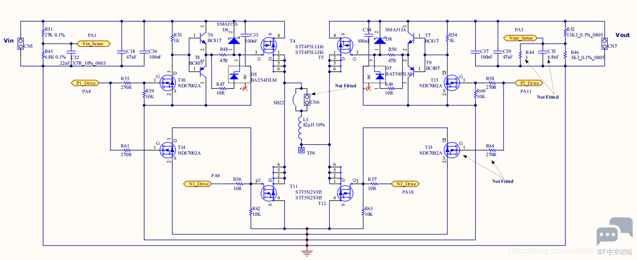

升降压电路
% s1 A7 k0 ^9 R4 T! \7 {* p! i  A) W4 [7 J0 h
# T- }2 Y3 F: E
/ S1 h* P- B7 q1 N
试验目的4 H2 S' s) s7 I' w3 |! d
输入电压范围2-5V,恒定升压到10V输出6 a' o7 q' ^2 m# B- C0 w
. B3 K* I: ^, G, Q' E  E! Z
实现原理. s( R: P- K& Q" y0 O
根据原理图得知,要实现BOOST功能,需要控制PA8恒为高电平
+ z6 m  F* Z! {然后控制PA10为高电平,PA11低电平时为电感L3充电。
) M% Q1 z+ U  \) K0 N" A0 ^再控制PA11为高电平,PA10低电平,让电感与输入电压一起放电,达到升压的目的
( ~. ^& I7 ^# l

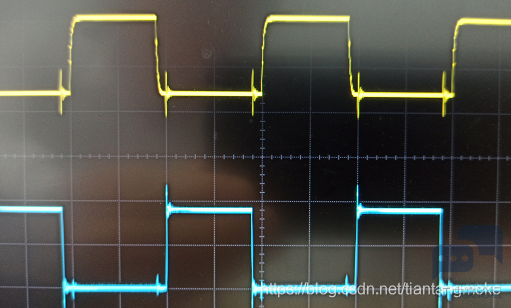

再配置HRTIM的频率为250KHZ
1 @7 l  K( ]: z# a6 B, L
! y6 h& p% R2 R
  1.   timebase_config.Period = BUCK_PWM_PERIOD; /* 250kHz switching frequency */  //OK3 R1 R* ~' Y9 u3 v- P3 L2 `
  2.   timebase_config.RepetitionCounter = 31; /* 1 ISR every 32 PWM periods */  //OK
    4 l( h" }! ?/ y9 y0 k
  3.   timebase_config.PrescalerRatio = HRTIM_PRESCALERRATIO_MUL32;  //OK
    ) Q4 u0 A9 ?% _8 I
  4.   timebase_config.Mode = HRTIM_MODE_CONTINUOUS;  //OK
    + b+ a" n# K1 e/ n
  5.   HAL_HRTIM_TimeBaseConfig(&hhrtim, HRTIM_TIMERINDEX_TIMER_A, &timebase_config);
    , [  O: y& b$ A1 E0 _
  6.   HAL_HRTIM_TimeBaseConfig(&hhrtim, HRTIM_TIMERINDEX_TIMER_B, &timebase_config);
# ?4 U$ h4 D1 d+ `
再对TIMERA和TIMEB的一些参数进行配置4 T8 m) a" r9 s  `9 U( I+ ~
3 s# n9 p% l# E: z
  1.   timer_config.DMARequests = HRTIM_TIM_DMA_NONE;//OK8 a8 h, K2 `9 n- @$ F& J
  2.   timer_config.DMASrcAddress = 0x0;//OK& I" I+ j8 a) Y2 @) ^5 M
  3.   timer_config.DMADstAddress = 0x0;//OK7 P$ F) j; w6 U8 k9 l; ]1 {( B
  4.   timer_config.DMASize = 0x0;//OK4 L0 F! t, q; \, G0 _* W
  5.   timer_config.HalfModeEnable = HRTIM_HALFMODE_DISABLED;//OK* R6 [" N# {8 y- j$ j
  6.   timer_config.StartOnSync = HRTIM_SYNCSTART_DISABLED;//OK4 [1 W7 I8 q' ?) u7 ~, G9 r
  7.   timer_config.ResetOnSync = HRTIM_SYNCRESET_DISABLED;//OK
    $ m* C' B: G& C4 ]  }' S2 [
  8.   timer_config.DACSynchro = HRTIM_DACSYNC_NONE;//OK
    ! ]0 L" n: B6 D( N) m
  9.   timer_config.PreloadEnable = HRTIM_PRELOAD_ENABLED;//OK; i+ w7 J* ^8 N" O
  10.   timer_config.UpdateGating = HRTIM_UPDATEGATING_INDEPENDENT;//OK
    $ E$ M# x6 F+ w
  11.   timer_config.BurstMode = HRTIM_TIMERBURSTMODE_MAINTAINCLOCK;//OK
    ) P/ r$ A; p/ ?6 p% C
  12.   timer_config.RepetitionUpdate = HRTIM_UPDATEONREPETITION_ENABLED;//OK
    0 l! Y* {# U( u2 ^$ C7 c+ l6 ^  @+ q
  13.   timer_config.ResetUpdate = HRTIM_TIMUPDATEONRESET_DISABLED; //OK9 K0 Q  ?" T$ \( t: k5 J
  14.   timer_config.InterruptRequests = HRTIM_TIM_IT_REP; //OK
    $ {; R" l' w; _& h, o' R
  15.   timer_config.PushPull = HRTIM_TIMPUSHPULLMODE_DISABLED;//OK- d8 Q  y0 R1 a' N# ^- R% s
  16.   timer_config.FaultEnable = HRTIM_TIMFAULTENABLE_FAULT1;//OK' d  W) M/ P/ p
  17.   timer_config.FaultLock = HRTIM_TIMFAULTLOCK_READWRITE;//OK/ A+ ~) U) X2 N% v# p
  18.   timer_config.DeadTimeInsertion = HRTIM_TIMDEADTIMEINSERTION_ENABLED;//OK
    0 O3 l4 _  ~2 h$ e! m* Z+ u; N
  19.   timer_config.DelayedProtectionMode = HRTIM_TIMER_A_B_C_DELAYEDPROTECTION_DISABLED;//OK
    ! L' c$ K) C5 g, y/ O  l% b
  20.   timer_config.UpdateTrigger= HRTIM_TIMUPDATETRIGGER_NONE;//OK  L- U; [: u  ~+ d
  21.   timer_config.ResetTrigger = HRTIM_TIMRESETTRIGGER_NONE;//OK
    & ]( b1 P: Q* _( @/ }+ _! f% f
  22.   HAL_HRTIM_WaveformTimerConfig(&hhrtim, HRTIM_TIMERINDEX_TIMER_A, &timer_config);
    ( t, V) }8 ^5 H; y( m* R0 }
  23. + g' y% N% D4 k
  24.   HAL_HRTIM_WaveformTimerConfig(&hhrtim, HRTIM_TIMERINDEX_TIMER_B, &timer_config);
! V# E  z) w, w& X! Y

死区时间配置,这一步配置完后,PA10和PA11高低电平不会完全重叠,将留一小段时间同时为低电平,如果不这样做的话,输入电源将存在短路现象
0 E5 q4 R/ j/ L
( P. X6 L  j  q- C* `
  1.   HRTIM_TIM_DeadTimeConfig.FallingLock = HRTIM_TIMDEADTIME_FALLINGLOCK_WRITE;//OK
    6 D3 h8 l4 J) W% x2 r! H/ k% L8 J
  2.   HRTIM_TIM_DeadTimeConfig.FallingSign = HRTIM_TIMDEADTIME_FALLINGSIGN_POSITIVE; //OK9 B" q2 G7 i% j* A' a1 ^* G
  3.   HRTIM_TIM_DeadTimeConfig.FallingSignLock = HRTIM_TIMDEADTIME_FALLINGSIGNLOCK_READONLY; //OK
    / e% P' r; i. w! E" K* B
  4.   HRTIM_TIM_DeadTimeConfig.FallingValue = DT_FALLING; //OK4 ^- v" o7 o" b+ d2 U& ]
  5.   HRTIM_TIM_DeadTimeConfig.Prescaler = HRTIM_TIMDEADTIME_PRESCALERRATIO_MUL8;" N; @8 I/ x6 N; p
  6.   HRTIM_TIM_DeadTimeConfig.RisingLock = HRTIM_TIMDEADTIME_RISINGLOCK_WRITE; //OK
      {, G1 S' U  M- z4 x" X$ H
  7.   HRTIM_TIM_DeadTimeConfig.RisingSign = HRTIM_TIMDEADTIME_RISINGSIGN_POSITIVE; //OK
    $ l1 q. y1 W* `# O
  8.   HRTIM_TIM_DeadTimeConfig.RisingSignLock = HRTIM_TIMDEADTIME_RISINGSIGNLOCK_READONLY; //OK
    $ D; s4 g' P5 s; m' Z3 t
  9.   HRTIM_TIM_DeadTimeConfig.RisingValue = DT_RISING; //OK
    3 z, c' C- f+ u7 I0 L- g; y* R
  10.   HAL_HRTIM_DeadTimeConfig(&hhrtim, HRTIM_TIMERINDEX_TIMER_A, &HRTIM_TIM_DeadTimeConfig);
    7 G8 Z* {" e+ ^
  11. ( A7 E) m, }$ R
  12.   /* Same parameters for Timer B */$ G. {( s  B0 k
  13.   HAL_HRTIM_DeadTimeConfig(&hhrtim, HRTIM_TIMERINDEX_TIMER_B, &HRTIM_TIM_DeadTimeConfig);
$ M  C  ?# Z' c2 W% R配置之后的波形:4 e) }1 F0 r# v( _% P; T- ]3 ]9 T3 B3 g
