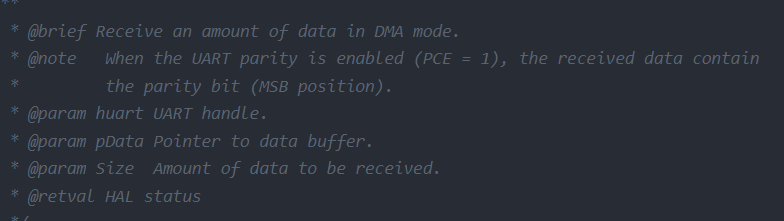

还是按照上一篇形式大概看一下,HAL库中DMA是怎么和串口配合的。; a4 g6 A$ P4 s$ U$ ?
0 E2 O' ]7 }0 d, @1 P5 Y
  1. /**- R. p( B) h4 N$ }8 Q! }3 `! D
  2.   * @brief Receive an amount of data in DMA mode.
    , Q6 Z: o6 D: \8 t
  3.   * @note   When the UART parity is enabled (PCE = 1), the received data contain
    ! O3 d& q5 u: ^/ G
  4.   *         the parity bit (MSB position).9 K( G" \* u4 Q" }) Q
  5.   * @param huart UART handle.% @* j0 r3 F# W3 A4 P
  6.   * @param pData Pointer to data buffer.
    $ r" D% b1 X; ?
  7.   * @param Size  Amount of data to be received.6 O% s% E7 L" e5 t" p
  8.   * @retval HAL status
    & V; |" O* o) B- _; r3 j
  9.   */1 O# r( r4 h, X* h) w
  10. HAL_StatusTypeDef HAL_UART_Receive_DMA(UART_HandleTypeDef *huart, uint8_t *pData, uint16_t Size)
