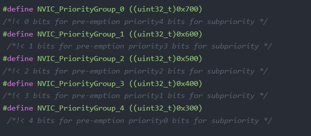

一、stm32的NVIC 分组配置
% b' Z; j0 S7 @STM32最多有 5 种优先级分组设置,这 5 个分组在 msic.h 中有定义。因为FreeRTOS 的中断配置没有处理亚优先级这种情况,所以我们只能配置中断优先级分组为 4,直接就 16 个主优先级,使用起来也简单!
2 I# p8 |  l0 v9 r/ V6 Q
  1. #define NVIC_PriorityGroup_0 ((uint32_t)0x700) + z# \8 s# W( k' R) G) n
  2. /*!< 0 bits for pre-emption priority4 bits for subpriority */; q! B+ x6 i  {8 w" g' s! {
  3. #define NVIC_PriorityGroup_1 ((uint32_t)0x600)( B' m9 I5 j: {
  4. /*!< 1 bits for pre-emption priority3 bits for subpriority */0 c5 _' V/ l+ _, n
  5. #define NVIC_PriorityGroup_2 ((uint32_t)0x500) % `2 n$ Q4 g; v$ |9 }* R" s
  6. /*!< 2 bits for pre-emption priority2 bits for subpriority */( q0 c( Y; D, H: D5 h4 [! Q, ~
  7. #define NVIC_PriorityGroup_3 ((uint32_t)0x400)
    ! x/ L% k6 S8 V: H; k( O' @
  8. /*!< 3 bits for pre-emption priority1 bits for subpriority */
    ! o( Q0 _, c& J6 W4 A
  9. #define NVIC_PriorityGroup_4 ((uint32_t)0x300)
    " Y  U$ v$ U& o" `: U
  10. /*!< 4 bits for pre-emption priority0 bits for subpriority */% J. ^6 y$ U/ p6 {4 C
8 z- |. i5 j+ `0 Y+ [
