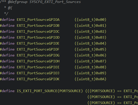

4 k( c  v8 w: I, o1 [# L- ASYSCFG_EXTI_Port_Sources! B, F4 z3 a& N7 b/ n6 F
0 q  u9 c3 Q$ s9 S6 D
  1. /** @defgroup SYSCFG_EXTI_Port_Sources ( Z# e8 R( b; P+ t4 I% r0 x
  2.   * @{
    9 E: G8 [' B) F, H1 }% o
  3.   */
    & p- C* {$ z% X3 Q
  4. #define EXTI_PortSourceGPIOA       ((uint8_t)0x00)) J) y" F4 L) Y
  5. #define EXTI_PortSourceGPIOB       ((uint8_t)0x01)1 G% I+ \8 r! C
  6. #define EXTI_PortSourceGPIOC       ((uint8_t)0x02)
    8 O& i4 A" }5 i0 u/ R9 L9 r# t
  7. #define EXTI_PortSourceGPIOD       ((uint8_t)0x03)9 x  g2 f' ~1 j# ^: B& {
  8. #define EXTI_PortSourceGPIOE       ((uint8_t)0x04)
    0 d4 `: a- n7 f
  9. #define EXTI_PortSourceGPIOF       ((uint8_t)0x05)+ I6 W4 @& j, k) w1 |6 c. l" r
  10. #define EXTI_PortSourceGPIOG       ((uint8_t)0x06); r8 i" {& B; t, E8 z5 Q$ j
  11. #define EXTI_PortSourceGPIOH       ((uint8_t)0x07)
    6 J( n6 h8 N( @) y
  12. #define EXTI_PortSourceGPIOI       ((uint8_t)0x08)
    & Q! w/ b& C) }; n
  13. #define EXTI_PortSourceGPIOJ       ((uint8_t)0x09)
    0 I- L1 m9 |8 `7 U
  14. #define EXTI_PortSourceGPIOK       ((uint8_t)0x0A)9 n, J" [& M3 ~; p* [. d4 e
  15. - `% i% s/ v8 z5 U' Z  Y  R
  16. #define IS_EXTI_PORT_SOURCE(PORTSOURCE) (((PORTSOURCE) == EXTI_PortSourceGPIOA) || \1 T& |0 x- O5 R8 Z( N( V4 T0 @
  17.                                          ((PORTSOURCE) == EXTI_PortSourceGPIOB) || \3 ^8 h( `1 a! C* D2 n
  18.                                          ((PORTSOURCE) == EXTI_PortSourceGPIOC) || \8 T$ |8 R- K4 l
  19.                                          ((PORTSOURCE) == EXTI_PortSourceGPIOD) || \
    ; v" b3 d3 X8 P- J& \
  20.                                          ((PORTSOURCE) == EXTI_PortSourceGPIOE) || \
    8 }5 M# o4 f+ M  f; Z: R
  21.                                          ((PORTSOURCE) == EXTI_PortSourceGPIOF) || \& I7 B  K" q3 G. s2 e4 ]- w  c- U8 _
  22.                                          ((PORTSOURCE) == EXTI_PortSourceGPIOG) || \
    3 |. \7 R8 n: `& w2 f" P
  23.                                          ((PORTSOURCE) == EXTI_PortSourceGPIOH) || \. T0 K3 W. Q6 R+ W/ i7 F
  24.                                          ((PORTSOURCE) == EXTI_PortSourceGPIOI) || \( h6 ?5 Q0 h/ ~/ c
  25.                                          ((PORTSOURCE) == EXTI_PortSourceGPIOJ) || \, x! r& O% a8 v" x$ c7 Y
  26.                                          ((PORTSOURCE) == EXTI_PortSourceGPIOK))
