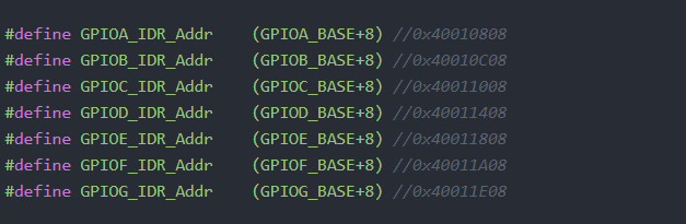

  18. #define GPIOA_IDR_Addr    (GPIOA_BASE+8) //0x40010808
    ( m9 J0 v# V- {0 U% j# Q7 }
  19. #define GPIOB_IDR_Addr    (GPIOB_BASE+8) //0x40010C08 8 l/ E1 h. z2 D# P3 |2 E
  20. #define GPIOC_IDR_Addr    (GPIOC_BASE+8) //0x40011008 & ~' B% |* X4 L! ^
  21. #define GPIOD_IDR_Addr    (GPIOD_BASE+8) //0x40011408
    # a# r; q0 q( O9 y, ]+ |
  22. #define GPIOE_IDR_Addr    (GPIOE_BASE+8) //0x40011808 ) ?5 F/ n; I# c: j4 o" ~
  23. #define GPIOF_IDR_Addr    (GPIOF_BASE+8) //0x40011A08 / k4 H( x# Y( a' f) h
  24. #define GPIOG_IDR_Addr    (GPIOG_BASE+8) //0x40011E08 * ]' M6 p1 J  K# n+ I8 I" \
