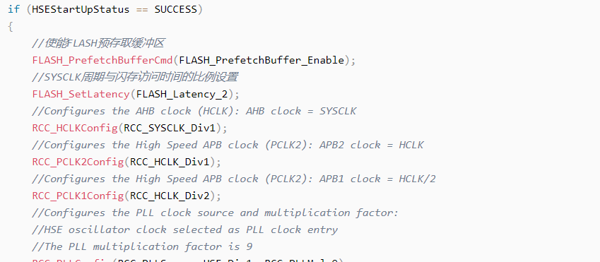

" n( j: u% p6 K配置RCC时钟
# b) T, ^' \/ V( c6 IRCC时钟配置是STM32MCU顺利运行的必备步骤,笔者使用的参考代码如下:+ l- Y" O4 }: O/ G' O& j
& @8 I# p# Q6 V! M+ h4 c- S
  1. void RCC_Config()7 R! `0 S4 f# ]/ @/ Z; o2 N
    % m4 p. _8 Y- J8 {
  3.         RCC_DeInit();! C7 l8 v* A  c6 h
  4.         //使能HSE,并等待 HSE 稳定- f: h- m4 r, m. {9 h
  5.         RCC_HSEConfig(RCC_HSE_ON);
    3 _  A- ^& W* w9 c3 ~
  6.         ErrorStatus HSEStartUpStatus;
    0 M& N4 G/ C# N& o
  7.         HSEStartUpStatus = RCC_WaitForHSEStartUp();
    0 x2 e  o8 |( a/ k# t3 Q3 \
  8.         //HSE启动成功- m/ w5 I- R: B6 T# h
  9.         if (HSEStartUpStatus == SUCCESS)
    ! P/ R& B) n$ f4 ~4 P4 A
  10.         {
    . `- l, Y& }6 v. i( \+ ?' d1 s% P
  11.                 //使能FLASH预存取缓冲区
    : p5 e1 h4 d5 t: h: K) y3 w1 X& B
  12.                 FLASH_PrefetchBufferCmd(FLASH_PrefetchBuffer_Enable);
    + ~& Z3 V' ]5 f
  13.                 //SYSCLK周期与闪存访问时间的比例设置
    3 j% y; {) }2 ~
  14.                 FLASH_SetLatency(FLASH_Latency_2);# L- J8 H% P$ |+ [) V( Q0 k
  15.                 //Configures the AHB clock (HCLK): AHB clock = SYSCLK5 M% k& I) f: h" y* O# [1 m
  16.                 RCC_HCLKConfig(RCC_SYSCLK_Div1);% X6 G" E4 _. n
  17.                 //Configures the High Speed APB clock (PCLK2): APB2 clock = HCLK/ t* P4 q- F- d, r/ J; j
  18.                 RCC_PCLK2Config(RCC_HCLK_Div1);
    7 U# C4 L) C- g+ y0 t' d" e
  19.                 //Configures the High Speed APB clock (PCLK2): APB1 clock = HCLK/2
    8 d3 u' m$ t$ D& `9 V2 g
  20.                 RCC_PCLK1Config(RCC_HCLK_Div2);( v$ Y& m% V& l2 z
  21.                 //Configures the PLL clock source and multiplication factor: # \$ ^* s0 J7 D% P! S' N1 e1 n
  22.                 //HSE oscillator clock selected as PLL clock entry5 y# P: Z; l! B0 g0 ?: b/ n
  23.                 //The PLL multiplication factor is 9/ d0 j6 h% n# h$ V+ X" P
  24.                 RCC_PLLConfig(RCC_PLLSource_HSE_Div1, RCC_PLLMul_9);( i( S7 I1 J6 k* l+ W
  25.                 //Enables the PLL.; W9 c" C( H* M- x) I( O% W
  26.                 RCC_PLLCmd(ENABLE);' W  j5 f" e0 q2 U1 q6 j) f: Y
  27.                 //等待PLL时钟稳定
    & @% \# F* K" G9 Z& F
  28.                 while (RCC_GetFlagStatus(RCC_FLAG_PLLRDY) == RESET)
    ) L. T+ i6 X, B) f/ L
  29.                         ;" b! o" H" R: ]$ F
  30.                 //Configures the system clock (SYSCLK): PLL selected as system clock
    6 ^0 y) D! d6 K8 V# `: c' {. `2 h4 |
  31.                 RCC_SYSCLKConfig(RCC_SYSCLKSource_PLLCLK);% X. U8 F; ]% |
  32.                 //读取时钟切换状态位,确保PLLCLK被选为系统时钟
      K8 |' }) D& h9 S8 W! s
  33.                 while (RCC_GetSYSCLKSource() != 0x08)4 D5 a) @* n  R! O
  34.                         ;
    ) v4 @* v/ V( C! a* K
  35.         }
    9 H; L/ B2 b6 P) g2 R
  36.         //HSE启动失败; @, C& ?% {. b- }- T) O
  37.         else& F8 N& N" t3 F
  38.         {& B+ G4 D* T: L
  39.                 while (1)
    ' m# B) g4 J5 t+ ^
  40.                         ;0 h' Y+ c- |6 b; u" d
  41.         }
    2 ^7 B/ H1 |+ O3 g3 l; q& r+ G; F
  42. }
