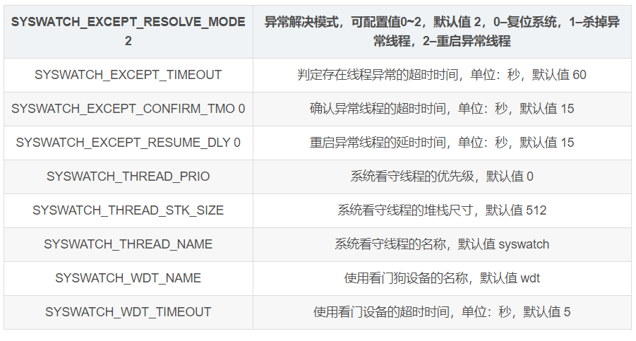

* A8 k* H* `; v& |, y8 I三、参数说明8 ?$ W& l* }5 H
syswatch_config.h中:
/ P; `0 `6 C. P  J  x6 P, ~" f' h; h. W% U$ n/ Z9 h" p( \
0 E; z! R+ V$ h( K- x' M& }1 v, _2 T4 \1 w; D/ X
