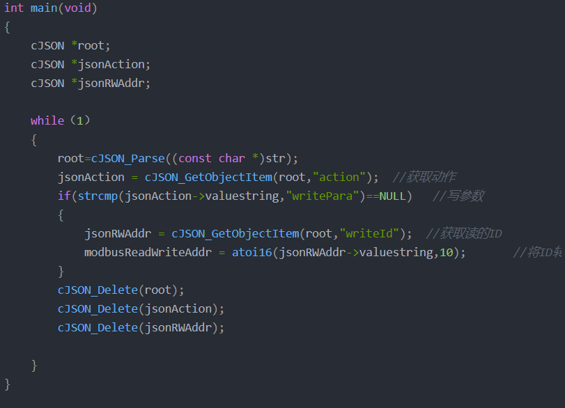

一、解析JSON格式数据
1 X, P# P. `2 d' b% Z4 @) h
5 f# \6 ]) K3 H8 Q2 D, b+ u
  1. //需要解析的字符串8 J5 b, w  n4 Y4 m; r
  2. char *str="{"action":"writePara","value":{"id":"1","frontId":"1","band485":"1200","bandCan":"10","sidewayTime":"10","sidwwaySync":"1","upDownTime":"10","upDownTimeSync":"1","hookMode":"electric","senseMode":"single","isStopCar":"1","originalIsStopCar":"1","isShiftLeft":"1","isShiftRight":"1","isShiftUp":"1","isShiftDown":"1","isRstData":"1"}}";
    % ?5 @! F0 |7 u1 Z% l( I- V% ^
  3. int main(void)1 @6 m* H$ M: ?! w% x5 _' ~
  4. {        ! q# ]* Y; c$ L5 ]( G# f. F, c
  5.         cJSON *root; ; u8 p5 O% F0 q; Y; ?9 u& p8 [
  6.         cJSON *jsonAction;7 g7 ^7 X$ H% p" O+ U6 w& s7 n
  7.         cJSON *jsonRWAddr;
    , ?: B# ^( a& ~# n  c* y& ~- i
  8. 1 |( S9 C2 \! O2 A* Y- U0 J
  9.         while(1)/ j8 h( o1 i7 v4 v
  10.         {1 ?  H5 S. }, `* i
  11.                 root=cJSON_Parse((const char *)str);
    6 ?2 U2 E* M6 `' {  y" ~, G* l
  12.                 jsonAction = cJSON_GetObjectItem(root,"action");  //获取动作
    3 U  j5 Q( t; f; \; ?4 ]$ G9 D  U
  13.                 if(strcmp(jsonAction->valuestring,"writePara")==NULL)        //写参数
    $ F3 ^& D/ }1 s9 w
  14.                 {
    & v3 g' N/ I: s9 Z  k
  15.                         jsonRWAddr = cJSON_GetObjectItem(root,"writeId");  //获取读的ID+ O1 [: K: d/ b, F* o3 a7 D, z
  16.                         modbusReadWriteAddr = atoi16(jsonRWAddr->valuestring,10);                //将ID转为int
    : o' m2 J( k& e: q7 Q. G
  17.                 }
    ) W; N; r6 A- \  h$ A' I* t) `) ?
  18.                 cJSON_Delete(root);
    . U3 L; ~  F( p1 @4 G" R8 s
  19.                 cJSON_Delete(jsonAction);5 B& y& D& T4 Z5 f% n9 ]
  20.                 cJSON_Delete(jsonRWAddr);
    , g- Z+ g. h+ B- `( d, I& B
  21. 4 c& |( s- d0 B( k9 c$ r# D
  22.         }+ G+ ^( i, j9 F/ x0 I% i  ]$ B" z
  23. }
