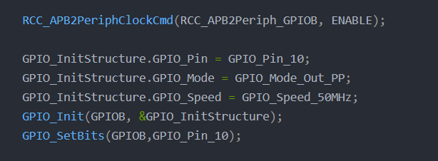

  4. void tm1652_init()* h) h, I: L. E. j2 {! \' X
  5. {
    : D4 ?& }7 I6 l2 `1 @1 G# V
  6.         GPIO_InitTypeDef  GPIO_InitStructure;
    . Y3 I3 ]' v, k1 S4 M9 V0 S4 d# R* \
  7. 4 H/ I2 V) S/ \1 m8 ]6 u% ^( F; E
  8.         RCC_APB2PeriphClockCmd(RCC_APB2Periph_GPIOB, ENABLE);3 e, ~8 P  C! ~! c) H9 I& h
  9. ) ]6 d( s) N! Z# w( @7 S6 h# J
  10.         GPIO_InitStructure.GPIO_Pin = GPIO_Pin_10;                                 0 A$ T- W9 Z1 B6 ]  k, J
  11.         GPIO_InitStructure.GPIO_Mode = GPIO_Mode_Out_PP;                  , W5 w6 H" ^' i" q$ a2 r0 X
  12.         GPIO_InitStructure.GPIO_Speed = GPIO_Speed_50MHz;
    ( c; @+ S4 \9 O  p1 j
  13.         GPIO_Init(GPIOB, &GPIO_InitStructure);
    7 P* S+ U! G3 {3 }+ ]( J4 v; z; w( R
  14.         GPIO_SetBits(GPIOB,GPIO_Pin_10);
    5 x9 U* B% v1 V7 @. s6 U
  15. - Z" r" V% {3 S0 Y! h
  16. }- d. W) \6 n5 y* n2 `
