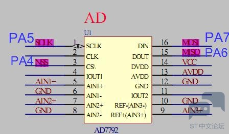

题二:在移植AD7792独立出来时,发现电池电压采样值打印为0000;- k0 k" |+ ]! U9 L# n. u
( G& C% N# b3 h6 r% _/ `/ ~: q5 u问题根源:SPI配置问题;
' T" ]; B. q4 {/ q; B7 ]! l. C
/ ]) j0 [8 q0 D! I  W6 g8 j9 x原理图:! {4 N1 w6 M+ w& W
2 I7 H- [* s7 U5 b1 p
9 G2 }2 Y: U: X: B
3 g% W" g# ?2 q+ X 错误配置:
# B( \' s5 Z! ^3 Y" [- T& B4 H9 f. A/ H: p' x. E  e. j: d& i! E6 N. ]/ J

正确配置:
; @$ @( O7 r" B& R$ Q0 N# f3 I0 B; \5 @
/* Configure SPI1 pins: SCK, MISO and MOSI */: S9 \% `( ?$ u9 L
& I# Z/ {  S$ a2 ~4 ?
GPIO_InitStructure.GPIO_Pin = GPIO_Pin_5 | GPIO_Pin_4|GPIO_Pin_7;
9 @/ C: ~8 k1 n1 I; A- J  \6 s. k) P
+ z- s: u' g. N9 p# `, \; j' `GPIO_InitStructure.GPIO_Mode = GPIO_Mode_Out_PP;    //通用推挽输出
. h/ ?: T0 W8 {3 o
8 g* ~2 W$ Y0 _2 D* q7 E1 lGPIO_InitStructure.GPIO_Speed = GPIO_Speed_50MHz;
4 F& c( v  @/ R! y4 u  Z  d; Y7 X" x
GPIO_Init(GPIOA, &GPIO_InitStructure);
  y, L& E/ k' ?1 j0 r! @& c; E% l! a# d; i3 d0 F) i) R- m( @
2 ^, P- @( R" e
4 V0 n. l- y+ `4 f, ]& x/ o
  /* 配置MISO为输入 */$ Z- y- ?, \$ c
. {& A: g* h! w! h. b2 l* Y# \7 KGPIO_InitStructure.GPIO_Pin =  GPIO_Pin_6;# q/ R/ T8 x0 l, @
1 L& l; j' y5 J6 l7 j( wGPIO_InitStructure.GPIO_Speed = GPIO_Speed_50MHz;# d& b4 i4 T  G8 [. e5 l( X' P
' U, R2 |+ r/ ]GPIO_InitStructure.GPIO_Mode = GPIO_Mode_IN_FLOATING; //浮空输入
$ T1 w0 V5 u$ u7 x, [
6 Y) ^3 b) a0 ?GPIO_Init(GPIOA, &GPIO_InitStructure);- Q, O8 L: ]7 U. O( ]+ x# Q
