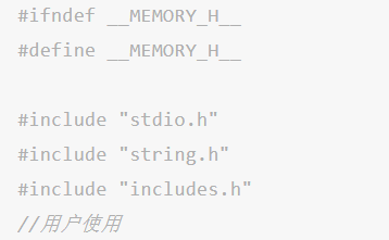

memory.h:
  1. #ifndef __MEMORY_H__
    $ A, @8 b' U0 n2 L. J; N' R3 |
  2. #define __MEMORY_H__6 D+ L! ~3 J/ R4 Y9 r! F' j
