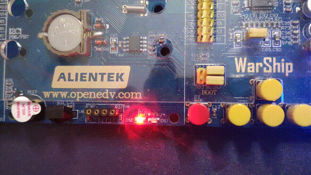

编译链接烧写到开发板,可以看到LED闪烁3 P4 x5 E* P6 R1 G' \9 [3 p( ~1 [) A

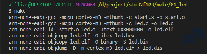

再修改Makefile如下,注意要有-mcpu=cortex-m3 -mthumb参数,这个很重要
6 E: t; [' l  B% a
* m" y: F/ `9 _
  1. all : start.S led.c
    ( l; `, X6 }6 S
  2.         arm-none-eabi-gcc -mcpu=cortex-m3 -mthumb -c start.s -o start.o+ ~3 j3 k) Z0 _% G: |* r- h
  3.         arm-none-eabi-gcc -mcpu=cortex-m3 -mthumb -c led.c -o led.o
    2 @) ^9 H+ U. H  ]! a2 ?: {3 ^& w1 z: M
  4.         arm-none-eabi-ld  start.o led.o -Ttext 0X8000000 -o led.elf8 B, A+ n2 h) Q  c$ @
  5.         arm-none-eabi-objcopy led.elf -O ihex led.hex8 v' _# p, G. J1 O: L, Y1 m, W. G
  6.         arm-none-eabi-objcopy led.elf -O binary -S led.bin$ d' p; c# O/ \; U# w/ U1 ?
  7.         arm-none-eabi-objdump -D -m cortex-m3 led.elf > led.dis
    ; _9 L. K  @" y" r- }
  8. ) D6 I' ~6 r& \  q/ H
  9. clean:
    7 B0 M5 g- f& y' v& u' q
  10.         rm -rf *.o led.elf led.hex led.bin led.dis
: I! {5 |6 `7 v使用make执行后如下
0 g! Q/ p" \' b 20210102175418537.png
- }3 A0 t- T3 e' [( A' |
& Q* q5 x; ~4 Y  ?4 K; C5 Q+ ^编译烧录后可以看到LED闪烁
2 H  M& D. P0 N6 W# j+ t8 a
2 W7 c- a/ p# N& T 20210102175449422.gif

四、优化Makefile0 y5 r/ m4 M5 Y8 Q3 z) p0 E
可以将Makefile优化为如下所示( L5 ~, B$ y1 \7 a
9 D0 k) B' u3 l3 @
  1. TARGET = led
    ! j0 ]3 T! K. q' H2 E' s
  2. + a+ H+ Q* T" _3 C* S
  3. OBJECTS = start.o led.o
    & l- i: @: s, A: p, }
  4. ) I3 q' N* s% N& W2 S) j
  5. CPU = -mcpu=cortex-m3
    ' w9 Q. M# L+ t& Z9 ?* D/ M
  6. MCU = $(CPU) -mthumb
    . K+ E5 ]" n8 {5 s3 I
  7. , g: X) Q: K4 a' f' K5 ^5 X5 g: {4 u
  8. CFLAGS = $(MCU) -Wall
    ( Y0 p0 I2 U3 R+ i& x. I  j* n
  9. 0 B8 y) d- {7 |' P5 Y8 p
  10. all : $(TARGET).elf $(TARGET).hex $(TARGET).bin $(TARGET).dis% E- M4 d5 [7 a+ `" ~
  11.         arm-none-eabi-size [        DISCUZ_CODE_6        ]lt;( C$ H* u) O8 w( J5 h) u+ D- v
  12. , k7 j; \) C% ^$ W5 Z
  13. %.o: %.c. D# x& x1 t7 J0 t+ n" H7 y
  14.         arm-none-eabi-gcc -c $(CFLAGS)  [        DISCUZ_CODE_6        ]lt; -o $@8 i6 c$ k8 H0 k  A" l4 S, ^
  15. 3 T8 r6 V1 q8 r& O! l/ v& z
  16. %.o: %.s
    & h- |; [8 \$ s& n1 ~2 e  Q! k' Z
  17.         arm-none-eabi-gcc -c $(CFLAGS)  [        DISCUZ_CODE_6        ]lt; -o $@, v& _# k- }! R+ d) d) V
  18. ) h, e: G& J* z/ y
  19. $(TARGET).elf: $(OBJECTS)! ~+ S) Q* ~( L3 ^" J3 D
  20.         arm-none-eabi-ld  $(OBJECTS) -Ttext 0X8000000 -o $@7 r. z5 s! a# z7 c5 z# n
  21. : L" d$ [% u8 K0 C
  22. %.hex: %.elf   r  z! v' O1 _; E4 z2 j
  23.         arm-none-eabi-objcopy -O ihex [        DISCUZ_CODE_6        ]lt; $@
    8 P% J# U% m+ N5 o) A1 T. M1 V! ^
  24. 1 B% j5 @  S. J  A
  25. %.bin: %.elf
    1 f: z3 b0 X2 g- F2 X: Y4 E; F
  26.         arm-none-eabi-objcopy -O binary -S [        DISCUZ_CODE_6        ]lt; $@& H! K1 v/ W7 ^1 f* n/ }4 j3 {' H4 ~
  27. $ c, Q7 m8 i. m5 D6 n' {$ w4 R# F2 }+ q
  28. %.dis: %.elf
    # i2 Q$ |: f1 O8 m, @: }5 E
  29.         arm-none-eabi-objdump -D -m cortex-m3 [        DISCUZ_CODE_6        ]lt; > $@
    8 d3 V3 z  x7 r5 y4 n7 b4 C
  30. * n1 X$ ~6 a2 i
  31. clean:
    4 ]: O3 E! F" o7 f
  32.         rm -rf *.o led.elf led.hex led.bin led.dis
: V0 h3 y# P# i7 I' q
